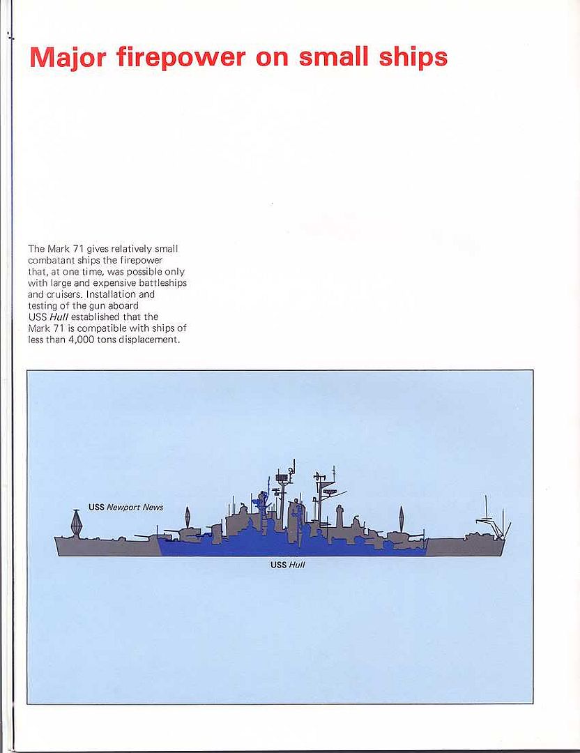

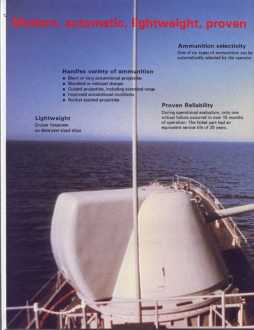

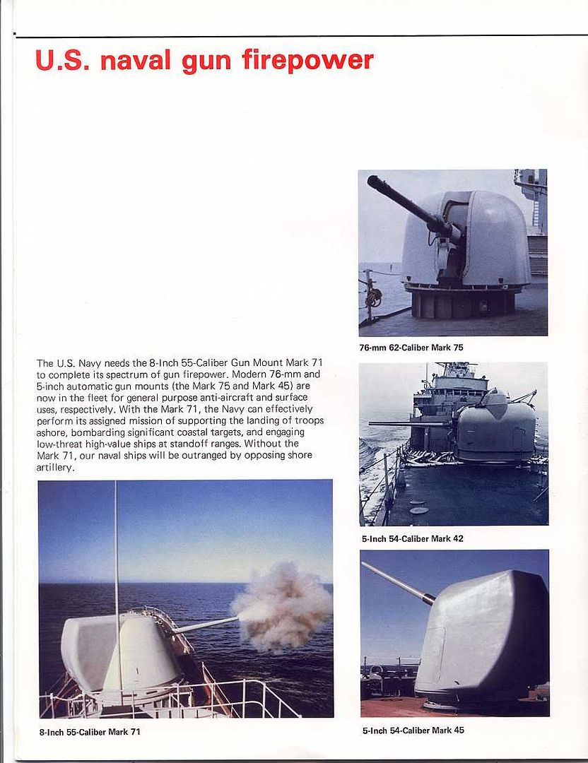

By: jackehammond - 12th September 2007 at 09:56

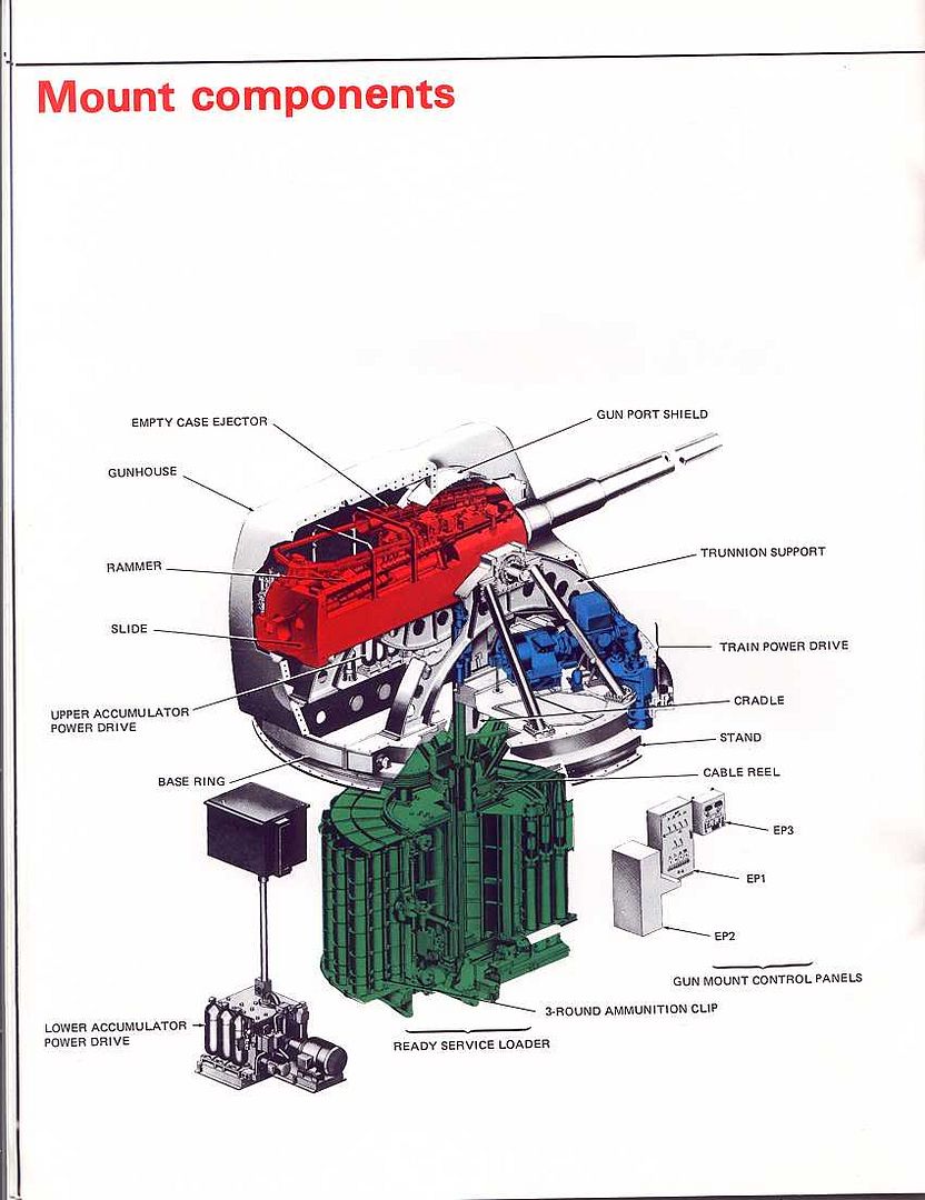

Folks,
This subject has been debated and discussed in the USA for decades. But a few items on the subject:
1. Everyone talks about upgrading to the 155mm cannon. Many don’t realize the massive increase in range and shell weight between a 155mm land artillery round and a naval 8 inch round. I don’t have the charts but it is massive for just a two inch increase in diameter.
2. While GPS guided artillery rockets are now as accurate as long range naval cannons of WW2, an artillery rocket can not do what heavy naval cannons did so well in WW2 and the Korean War: destroy deep and heavily re-enforced bunkers and other field fortifications. Israel recently discovered this fact in its short war with Lebanon.
3. One suggestion put forward by US Navy officers after the last US battleship was retired after the Gulf War 1991 was to remove the turrets and cannons from the battleships and replace them with mock turrets and cannons for museum use and fit the turrets and cannon to sea going barges which would be towed to where they are needed in times of conflicts by sea tugs.
4. It is irrelevant today as far as the super large naval cannons. The US Navy to make sure the battleships never came back ordered the destruction of the spare 16 inch barrels and the large metal bars stored to make them.
Finally, if anyone is interested, click the thumbnails below for the FMC brochure on the 8 inch cannon/turret that the USN developed after the Vietnam War. This was the best and last great hope for large caliber naval cannons for fire support. The US Navy decided (against strong US Marine objection) to cancel the project just as it was about to be funded. Pages 6 and Pages 7 I think all will find of interest.
Jack E. Hammond
