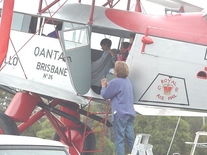

This is an interactive display, so people (especially children, but everyone)can get inside, and feel what it was like to sit in the real thing 80 years ago.
http://www.airwaveyachts.com.au/Aircraft/kids.jpg

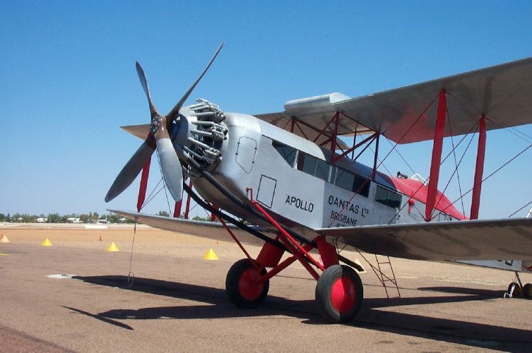

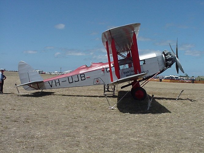

Today the replica sits in the old hangar where the original aircraft sat eighty years before.
http://www.airwaveyachts.com.au/Aircraft/QANTAS%2017.JPG
http://www.airwaveyachts.com.au/Aircraft/DH61web.jpg
