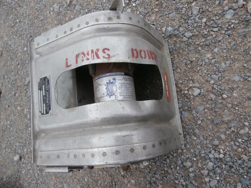

Gun chutes and Coffman starter to ID please!
A mate was clearing out his garage and came across this lot – any ideas anyone – if they can help anyone I’m sure he would consider passing them on….
http://i37.photobucket.com/albums/e62/TEXANTOMCAT/P7200088_zps99efd2b9.jpg
Looks postwar – maybe .50 – Hughes Aircraft marked

By: TEXANTOMCAT - 20th July 2014 at 18:17
Blimey – that was quick! Thanks chaps – the darker chute isnt ADEN though, not wide enough to accommodate a 30mm round and we have an ADEN on display in the Museum – pretty sure its 20mm -so Meatbox it probably is! Thanks everso for your help – a forum member has just PM’d as he has a use for the Coffman, will put him in touch with the owner !
Much appreciated – have a good rest of Sunday !
TT

By: MerlinPete - 20th July 2014 at 17:47
The second one looks the same as the chute on a 30mm Aden I have at work (see photo)
The Coffmann starter component does look like Merlin or Griffon.

By: Arabella-Cox - 20th July 2014 at 17:33
Hi TT,
First chute could be from a US-built gun turret. I think the B-24 had Hughes turret(s). The second looks like it could be Meteor as the offset would allow it to fit an installation which had one gun above the other.
The Coffman starter, judging roughly by the size of the foot nearby, is too small for a Nene but too big for something like a Gipsy Major/Chippie installation. My guess is something Merlin sized, possibly Hornet/ Sea Hornet.
I would be interested in the suspected Hispano chute for my Meteor Mk.8.
