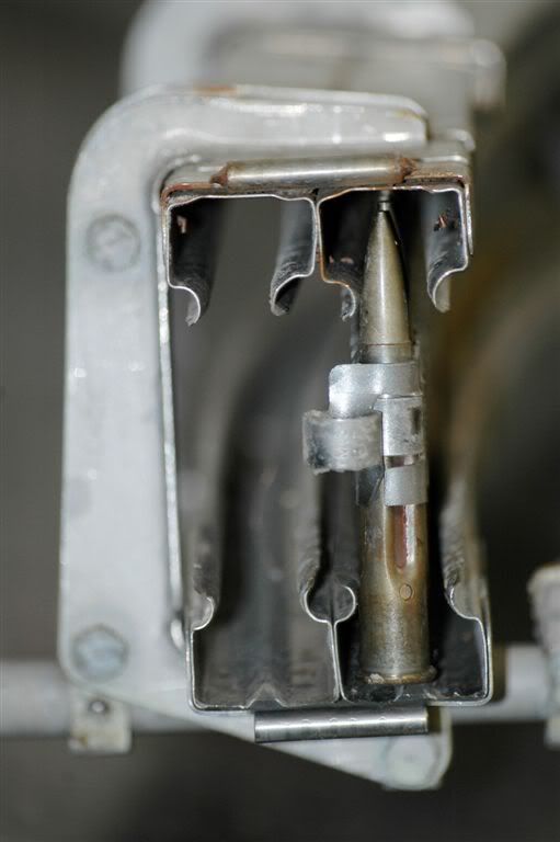

By: turretboy - 15th June 2007 at 02:57
Photo below shows the profile of the Lanc ammo ducts.

We actually have a lot of the traywork, we probably have only about 10 or 12 feet that got mangled.
It is in stainless steel and a very complex form to carry the weight. I was hoping to be able to get away with a fair copy of the exterior of the track, but that is also a quite complex form.
I guess we will have to ‘bite the bullet’ and re-manufacture the tangled sections.
Just FYI I will take some close ups.
Thanks again for your input.
