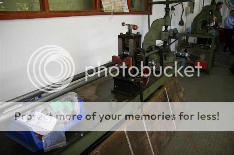

Hi,
Can anyone explain to me how the Hawker Aircraft tube-squaring device works? I understand the basics that the tubing is drawn into the device and squared cold using rollers. Changing the rollers allows different sizes and shapes. But what mechanism draws the tube into the rollers? What do the gears on the front of the device specifically do? And what does the hand wheel at the top of the device do? What are the rollers made of? I would suspect they are made of heat treated steel.
http://i379.photobucket.com/albums/oo236/rcafman/tube_squarer.jpg
http://i379.photobucket.com/albums/oo236/rcafman/IMG_9996Medium.jpg
Any help is much appreciated

393
By: DaveR - 11th January 2014 at 10:40
Thanks again Ross
I wonder where all the Hawker drawing archives are? I’d like to find a drawing for this machine.
The machine you see in the picture was reverse engineered from photographs and some original rolls that were found (in South Africa I believe). As far as I am aware there are no surviving hawker drawings for the squaring machine but the drawings do survive for the standard rolls, I would love to be proved wrong on the machine drawings as it will save me some time that I am spending re-drawing!!
96
By: Jag248rpa - 10th January 2014 at 22:30
Thanks again Ross
826
By: Ross_McNeill - 9th January 2014 at 18:31
Not used this machine but looking at the rollers below the bench it looks like one corner and two sides per roller.
The cold drawing one I had experience of back in the 80s took between 2 to 3 passes before the work hardened and had to be treated before the next 2 to 3 passes.
Usually the task was done in the first 2 to 3 passes.
Waste end of tube was belled and gripped by chain draw then 1st pass die (rectangular or square to suit) which had slightly oversize rounded corners and sides clamped round it (2 or 4 interlocking sections)
The tube was then pulled through the 1st die.
Next the tube was returned to start and die changed to finishing die of required section.
1 or 2 more passes to give final section form and polish.
Final action was to cut off drawing end to leave reduced section of required length.
Regards
Ross
96
By: Jag248rpa - 9th January 2014 at 18:12
Think of it as a combined English Wheel and slip forming rolls.
The handwheel on top puts manually incremented pressure on the tube to reduce the section. Each pass a twist reduces the gap slightly.
The gears allow the turns of the crank handle to draw the section through the rolls until the required length is cold formed.
Regards
Ross
Thanks Ross,
So does it take several passes to square each end. Are all four sides of the tube squared at the same time?
1,978
By: j_jza80 - 9th January 2014 at 18:03
It loos like the rollers draw the tube through, via the gears and the crank handle. The handle at the top looks like it determines the placing of the rollers.
826
By: Ross_McNeill - 9th January 2014 at 18:03
