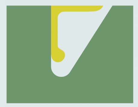

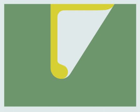

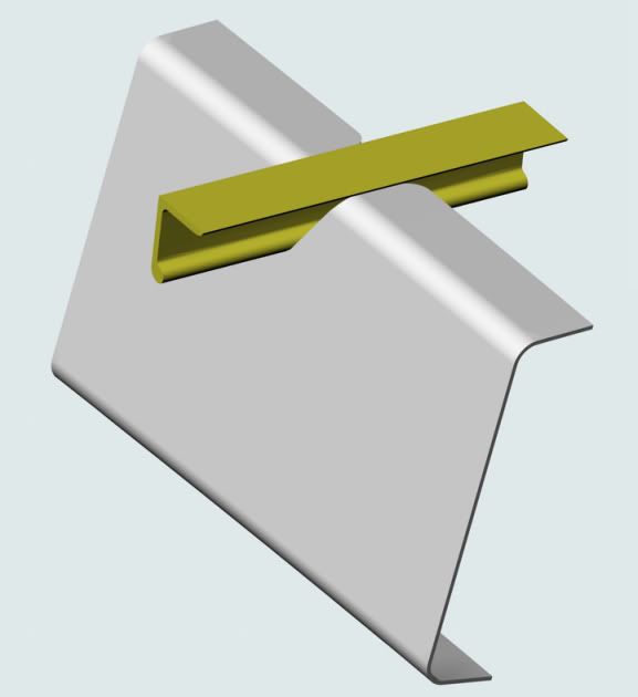

This is for my CAD Lanc project and is about the fit of stringers within former/frame slots. I don’t think the past 70 years have made much difference to the placing of stringers in frame slots
http://i648.photobucket.com/albums/uu207/MikeHoulder/Lanc%20Fuselage/3D.jpg
I have not been able to find cross-section dimensions for the stringers in the nose section of the Lanc. But I do have the dimensions of the slots.
It seems to me that the slot dimensions could give a good approximation for the stringer values. It comes to a question of how closely the stringer cross-section fills the slot.
So here are two possibilities: a tight fit and a slack fit. Which is correct or which is the closest? Or is it just in between?
I suppose there are two questions. Does the stringer bead go right to the bottom of the slot? Does the stringer tongue fill the top of the slot?
slack fit
http://i648.photobucket.com/albums/uu207/MikeHoulder/Lanc%20Fuselage/small.jpg
tight fit
http://i648.photobucket.com/albums/uu207/MikeHoulder/Lanc%20Fuselage/large.jpg

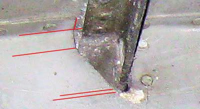

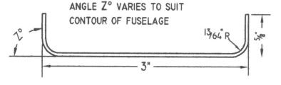

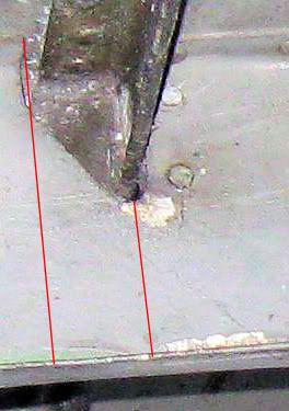

The formers in your photo seem to come from the centre or the rear centre section of the Lanc. All formers in these two regions, except transport joints, are made with either 18 gauge (1.024 mm) or 10 gauge (2.588 mm) Alclad sheet. The former nearest the camera is 18 gauge; the next is 10 gauge, the third is either 18 or 10 gauge. I’m not sure of the last.
All three formers are facing the same way. That should have been enough to identify the formers 100%. The best I can do is to identify them probably as formers 23, 22, 21 looking to the front. Do you know better?
Here are some pics to show you what I am doing to extract the data I need:
A section from a Lancaster engineering drawing
http://i648.photobucket.com/albums/uu207/MikeHoulder/Lanc%20Fuselage/Image4.jpg
A framework to apply known dimensions
http://i648.photobucket.com/albums/uu207/MikeHoulder/Lanc%20Fuselage/Image2.jpg
http://i648.photobucket.com/albums/uu207/MikeHoulder/Lanc%20Fuselage/Image1.jpg
Angle Z in this case is 90 degrees. I need to think a bit more before deriving the numbers – tomorrow’s job.
