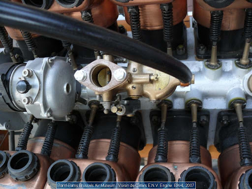

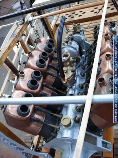

I personally agree with Creaking Door and think it could be an upright, inline 6 cylinder water cooled internal combustion aero engine.
The copper and brass is consistant with the water jackets etc applied to the cast iron cylinders of other water cooled aero engines of the period such as the V8 E.N.V. (as seen under restoration in the De Cater’s Voisin in Belgium below), and therefore not neccessarily indicative this engine is associated with either marine applications or steam locomotion.
Links to the above pics as they do not seem to be visible?
http://picasaweb.google.com/bamf.bamrs/VoisinDeCaters/photo#5188458859203623650
http://picasaweb.google.com/bamf.bamrs/VoisinDeCaters/photo#5188458683109964434
I have a 1972 reprint of “The Aero Manual – 1910”, it describes the water cooled V8 E.N.V. ,the water cooled upright 4 cylinder Bayard-Clement and the water cooled upwright 6 cylinder Buchet motors.
I suspect the Howcraft engine is a self created engine on the same principles?
It seems from the photo below that:
1: It is possible spark plugs exist top dead centre of the cylinders
2. It seems the fuel inlet manifold is missing from the LHS of engine (can we have a better side on pic from that side?
3. It seems the water inlet manifold was located on the top of the engine adjacent to the sparkplugs?
4. It is assumed the carburettor is missing with the inlet manifold?
5. There is an exhaust gas manifold on the RHS of the engine, venting to the rear?
6. It seems there is a water jacket outlet manifold on the LHS of the engine
7. It is assumed there is some inlet and outlet to the manifold to allow connection to an external radiator and header tank that was a feature of water cooled aircraft of the period?
8. the “front” of the engine has a single gear/cog fitted to the crankshaft, possibly a drive shaft for the magneto?
9. The “rear” of the engine has three gears/cogs fitted to the main crankshaft, the closest to the engine drives the two camshafts, (one of the camshaft gear/cogs is missing).
10. The remaining two large gears/cogs are identical, and appear to be for chain drives to propellors, suggesting a Wright Flyer type twin pusher prop configuration?
