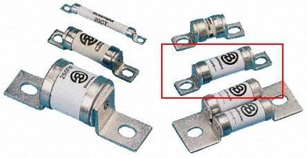

Photo from RS Components catalogue …. book 1 page 312 ….. 80amp semiconductor protection fuse to BS88 actual fixing hole centres are 41.8mm ?
This particular item is from the Bussmann range, other makes are available !
Fast acting, 240v AC, Max DC voltage 140v.
There is a 50 amp version but with the same dimensions, can’t find one with 33mm centres ? £6 . 37 each + VAT
