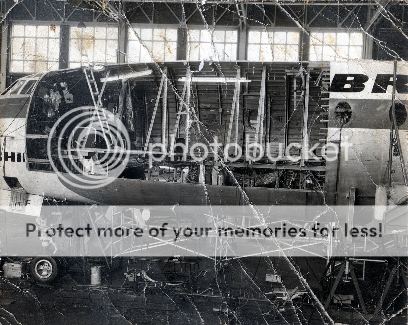

Here's an oddity
Found an old photo at work that was dumped amongst a load of Junk, so i scanned it, I think it’s possibly a British Midland freighter conversion ongoing, it’s a bit creased, but I thought you’d like to see it.

As far as our records show the two Eagle Britannia’s CF and CG had ex military 252 freight doors and VF and VM had the larger doors fitted. I think its correct to say that the smaller doors were 72”X88” and the larger ones were 76”X 122.75.
The first door mod took six months to complete and total hours were 67,000 man hours. In addition to the door the floor beams were reinforced. The basic weight of the aircraft was increased by approx. 300lbs. Both CF and CG had very low flying hours when purchased from Transcontinental SA. The first aircraft cost £150,000 that also included a maintenance check 4.The aircraft could carry as follows
5 pallets plus 37 passengers
4 pallets plus 61 passengers
3 pallets plus 7 passengers
2 pallets plus 103 passengers
1 pallet plus 121 passengers
All freight 8 pallets Pallet size 108”X 88”

I certainly remember being told that the ATL door was bigger (wider) than the RAF door, but whether Eagle used different size doors on their conversions I have no idea. CF & VF were both eagle conversions, I believe CD, CE, VS and may be others were ATEL conversions.

There were two sizes…the ATL which was took the larger pallets and the Bristol one which was smaller and of a type that would have been built into the aircraft if fitted during production but added later to some aircraft. In other words the standard (Bristol) door and the ATL mod.
I seem to remeber seeing a pic of ‘CF and ‘VF parked together at Manston with Invicta and noticing they had a different freight doors…long time ago now.

Many thanks Tony for posting the picture of Britannia G-AOVF its a gem. Although I was never based at Liverpool the picture brings back many memories of when we converted the first Britannia into a freighter at Heathrow,now the subject of a long term restoration at Liverpool. One only hopes that the future of VF is secure at Cosford. Viscount is right we at Heathrow converted G-ANCF and G-ANCG. Liverpool converted G-AOVM and G-AOVF. although both were supervised by Eagle staff from London and from Bristol Fliton.

Clearly British Eagle’s Britannia 312F, G-AOVF “Friendship” undergoing large freight door installation as already identified.
Although I did not recognise the hangar at first, looking at my notes and at other photos, the location is quite certainly in Liverpool Speke’s Hangar No.1. G-AOVF arrived for freight door installation on 28th February 1968, flew an air test 12th August and returned to Heathrow for service 15th August – which presumably puts a date on the photograph circa April/May ’68. Some sources state that British Eagle’s freighter conversions were all undertaken at Heathrow are wrong – indeed G-AOVM was also converted at Speke before ‘VF. Only seen one other photo of a Britannia undergoing freighter conversion with British Eagle Engineering at Liverpool, so can you go through the pile of junk again? Good find despite the creases.

It wasn’t always practical to change them back for normal civilian flights.
You wouldn’t be able to turn them round as they are stressed differently, same as the VC10 one… Speaking of which, the article about the periscope in the rear of the ten in Flypast is wrong, it wasn’t to look at the engine intakes, but to look into the rear baggage hold as it had smoke detectors but no fire bottles, so it was to check if it was actually on fire. You could see the intakes out of the windows.

It depicts British Eagle’s Britannia G-AOVF which was named “Friendship” and was converted to a 312F freighter in 1968. Later flew with a series of UK and African independents before withdrawal from use. Surprisingly it survives (painted in spurious RAF colours) at Cosford where is masquerades as XM497.

Looks like a Britannia conversion.
