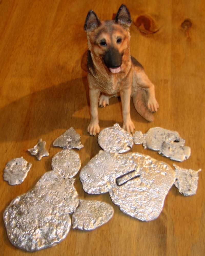

Alloy casting has been going through my mind recently too, mainly to make motorcycle parts, and have been amazed at how the temperatures in an ordinary domestic fireplace can melt some alloys.
Bearing in mind how touchy the authorities have become over guns in the UK, I thought I would destroy a replica Walther P38 pistol which had been knocking around the house for decades. This is what I found in the grate the next day…
http://i292.photobucket.com/albums/mm14/handshifterAl/Molten.jpg
