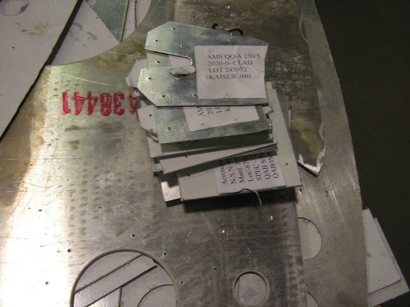

Cutting
Lazer?Go waterjet,no worries on heat effected zones on cut edges.All you need is a Cad file and a good system of organising the parts.All fastener holes can be centre marked..And I have enough trouble doing the Spit so if I was arm twisted enough might be able to help.Ummm how many parts we talking of here and what have I got myself into??:eek::(:rolleyes:

I am sure you know about the experimental category in Australia. Any Gipsy Moths built would be done under that, they would not be type-certified aeroplanes. They would not be DH Gipsy Moths, they would be replicas, very close replicas
That gets around a lot of things, paperwork wise, and allows that they could be maintained by the builder.
I have been told and others may be able to confirm this, that in a wooden Gipsy Moth the fittings are made out of flat metal plate.
If so that is a dead sitter for lazer cutting of the fittings.
