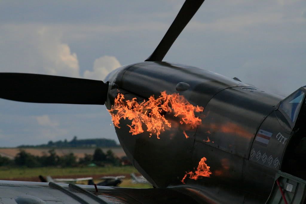

By: Eye on the Sky - 6th September 2007 at 14:35
Does this qualify? At Legends this year.
http://i202.photobucket.com/albums/aa195/Deano86/DuxfordFlyingLeg2067.jpg
Dean

By: ZRX61 - 6th September 2007 at 00:55
You can do it with a Merlin or a Griffon as well, I have, oops. Over primmed and a full set of flames from all twelve exhausts..
mick
I’ve been on the recieving end of that with P51’s..which standing on the wing ********* about with something 😡 (yes, plural, I guess I didn’t learn the first time..) At least the big fan up front kinda cools you down & extinguishes the conflgration once the engine catches…:)
Sometimes I hate pilots…… lol
