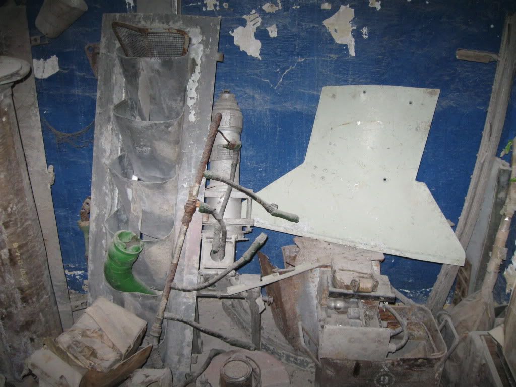

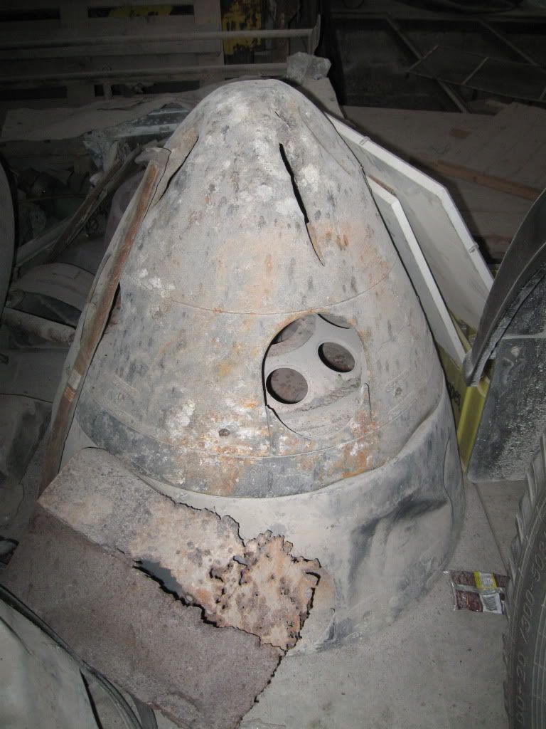

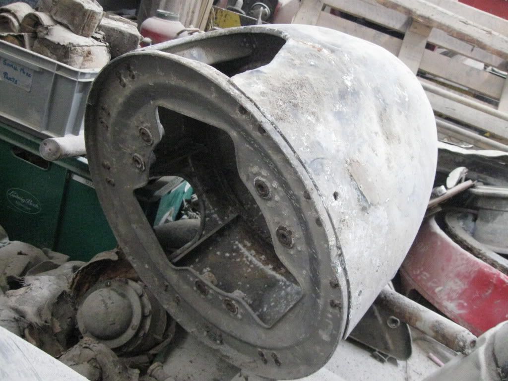

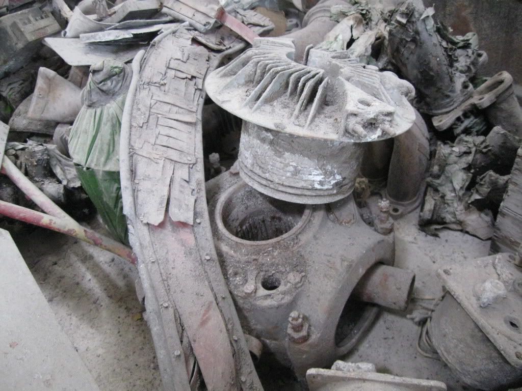

This black spinner for a 3 bladed prop looks Mosquito to me,can anyone who knows for sure please id it, we believe the hub below matches this spinner. Recently found in a scrapyard along with the other parts visible and a 2nd mysterious spinner……..ex RAF or RN stuff from the nearest airfields I suspect……thanks to all who reply!

8,945
By: Peter - 16th March 2012 at 00:55
First one looks more like lanc or mossie to me…
8,945

324
By: H.M.S Vulture - 15th March 2012 at 19:57
The second spinner looks like front one from a Gannet.
The exhaust stubbs are early Shackleton(Griffon).
So is the Cowling panel.

100,651
By: Arabella-Cox - 15th March 2012 at 19:02
Parts i/d
Prop hub looks like Shackleton (Griffon) front hub.
Spinner likewise, though there are some detail differences to ones I have in my possession.
There’s a Dowty hydraulic pump and the mushroom shaped part is a junk head from an early Hercules engine.
The exh stubs I have seen before and I think were the subject of an i/d parade on this Forum before. I think the verdict was Allison or Sabre engine.
The cowling side panel with the exhaust-type baffles could be Lincoln.
Anon.
