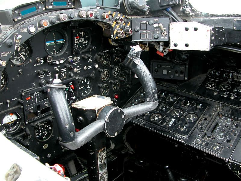

Canberra PR9 cockpit taken at Kemble last year when the aircraft were handed over to their new civvie owners.
http://img.photobucket.com/albums/v165/YakRider/Canberra12Cockpit.jpg

Here are some shots I took inside the PR9 before they left service.
Canberra controls
