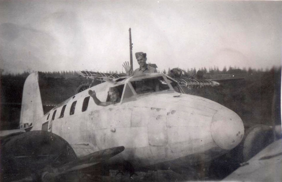

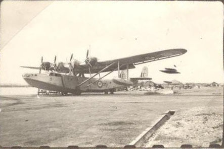

A puzzle for you all, the following three photos were found in a friend’s family album, all we know is that they were taken in Indonesia sometime between early 1946 and 1947. The twin lying on what seems to be a dump is a Tachikawa Ki-54 ‘Hickory’, the flying boat is as yet unknown to me. Can anyone shed some light on the following questions:
– What type of flying boat is this and what was it doing in those parts?
– What are the markings on the Ki-54? It seems a sort of square but I can’t think of what that would do on a Japanese aircraft. Any relation to the two fuselages that are still around possible? (Clues as to what is in the background and where this might be also welcome.)

The Mavis started out as an aircraft captured by the Indonesians. It then fell into Dutch hands and finally it was held by the British who eventually scrapped it. The Hickory is a bit of a mystery. The fuselage marking does not tally with Indonesian insignia of the day. Indonesian aircraft were marked either with a red and white rectangular marking or a red and white roundel.
Keith,
This Hickory could be one of the Indo. birds that were operated by them while under the Japanese Force’s they had the Black Trim with Red Square. I think the location of these photos are at the North End of the Java Airdrome this was the main holding are for most of the Japanses Army Aircraft. I’ve seen other photos of this holding are showing other aircraft with the same square marking on them most of these aircraft are transport type.

I suspect the Mavis is the one that was marked up as ATAIU -SEA

Hi Archer,
So let see if I can help you out,
1, Yes its a Kawanish H6K but its one of the 20 H6K4-L unarmed transports build for Greater Japan Airlines the Allied codename is “Tillie” three of them were capture by the English when the Japanese surendered. The location I’m guessing is in Java at the old Surabaya Seaplane base.
2, The markings on the Hickory are those of the Indonesian Air Force a All Red Square with a black border.
3, The aircraft behind starting with the one the far to the right that is a Nakajima L2D the ragwing aircraft is a Yokosuka K5Y Biplane, and the fighter that you can see in the third photo is a Nakajima Ki-84 it appears to be the -Ib version. For location I would say it most likely was at the Jakarta Airdrome, this is were most of the Japanese Army aircraft ended up.
As for what is left nothing all of the stuff were scrapped by the end of 49.

i dont know what the markings on the hickory are but could be surender marking do you have a side shot?the flying boat is a kawanishi h6k mavis.
paul
