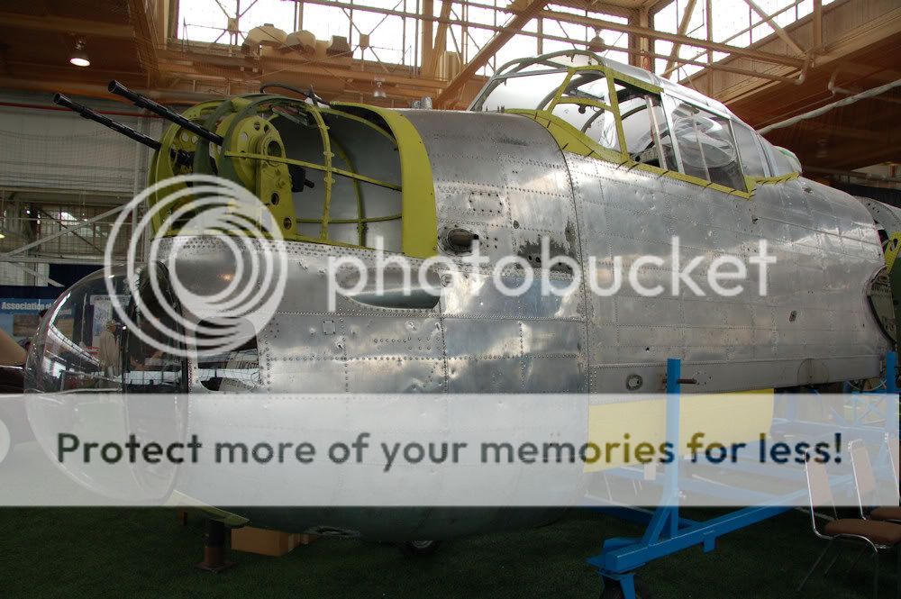

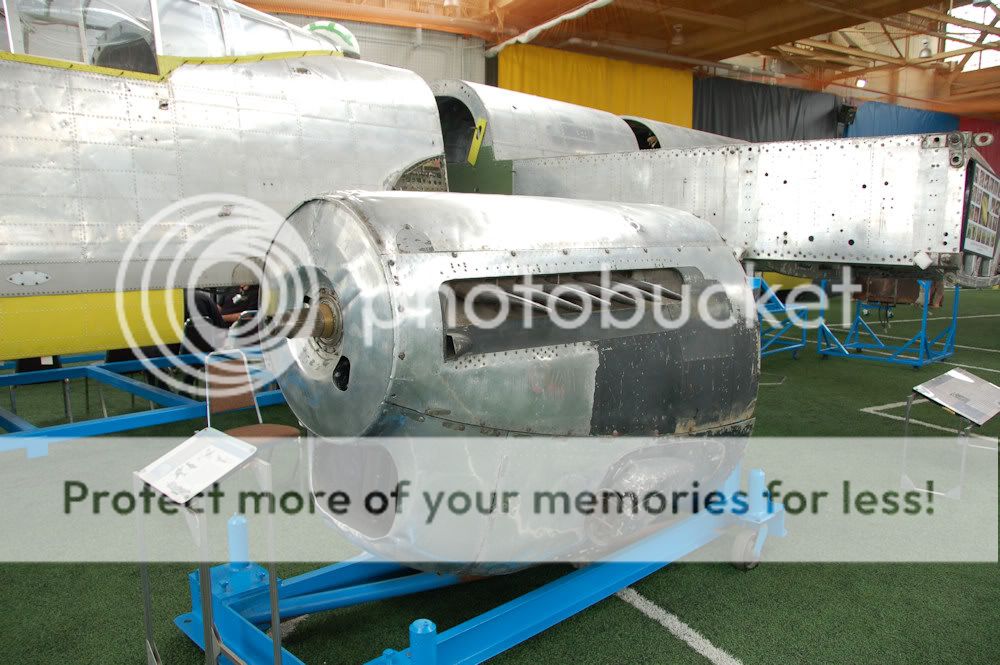

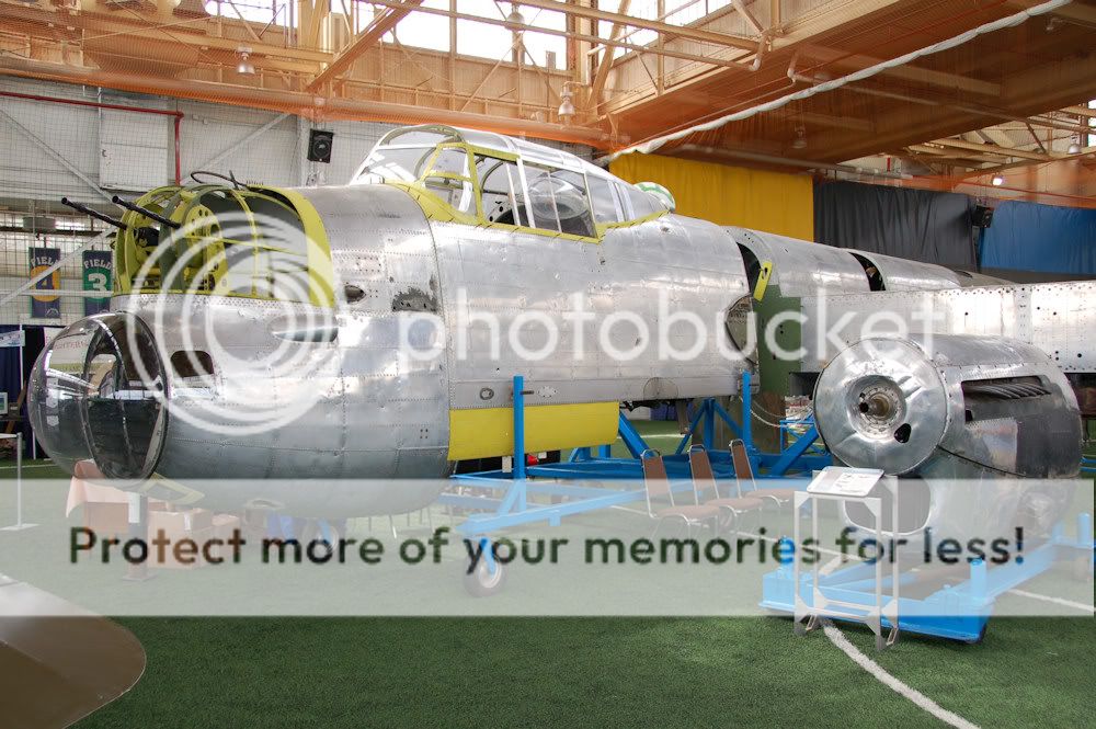

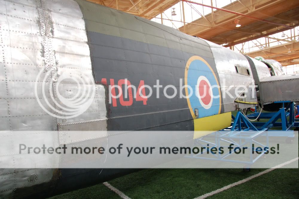

I thought I would give Canadian Air & Space Museum’s Lancaster FM104 a little exposure as she doesn’t get as much glory as other Lancaster’s get these days. She was on display as part of the open house Wings & Wheels festival held for the last few years at the Downsview museum.

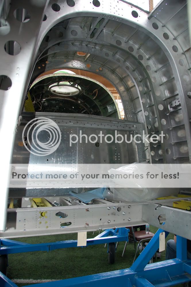

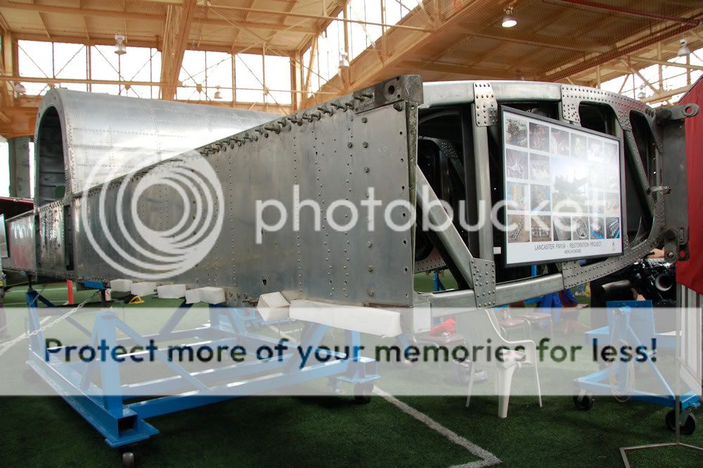

Her restorations does seems to take a slower pace ( compared to other similar projects) but I did notice quite a few changes from the last time I visited in 2008. Some work have been undertaken on the center section rebuild and it looks fantastic to me. Since the aircraft was pretty gutted I am guessing quite a bit of building from scatch has to be employed in this restoration.
I sorta wish that they finish FM104 in a RCAF Search and Rescue post war scheme but that ain’t going to happen..

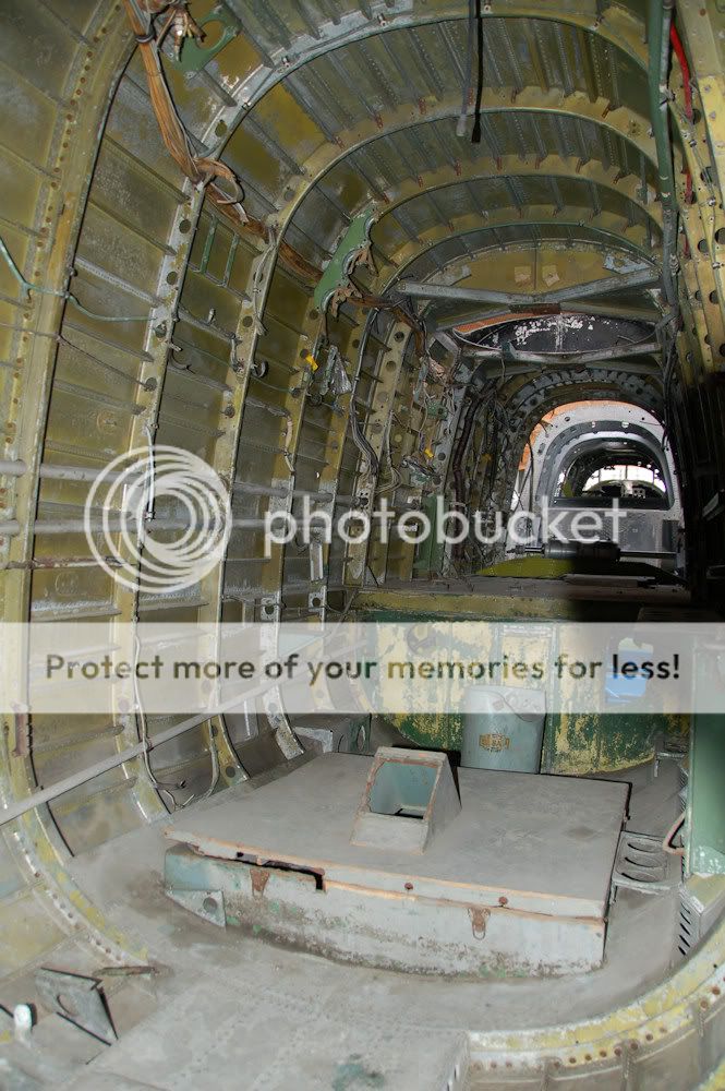

The team is still concentrating on repairing/rebuilding sections of the spar & floor section behind the cockpit that was cut/burnt out to accommodate the mounting of the airframe on a plinth at Toronto’s waterfront. Some replacement components have been salvaged from a section of FM118’s fuselage which sat on a gunnery range at CFB Shilo, Manitoba…..the bullet holes are being meticulously patched.

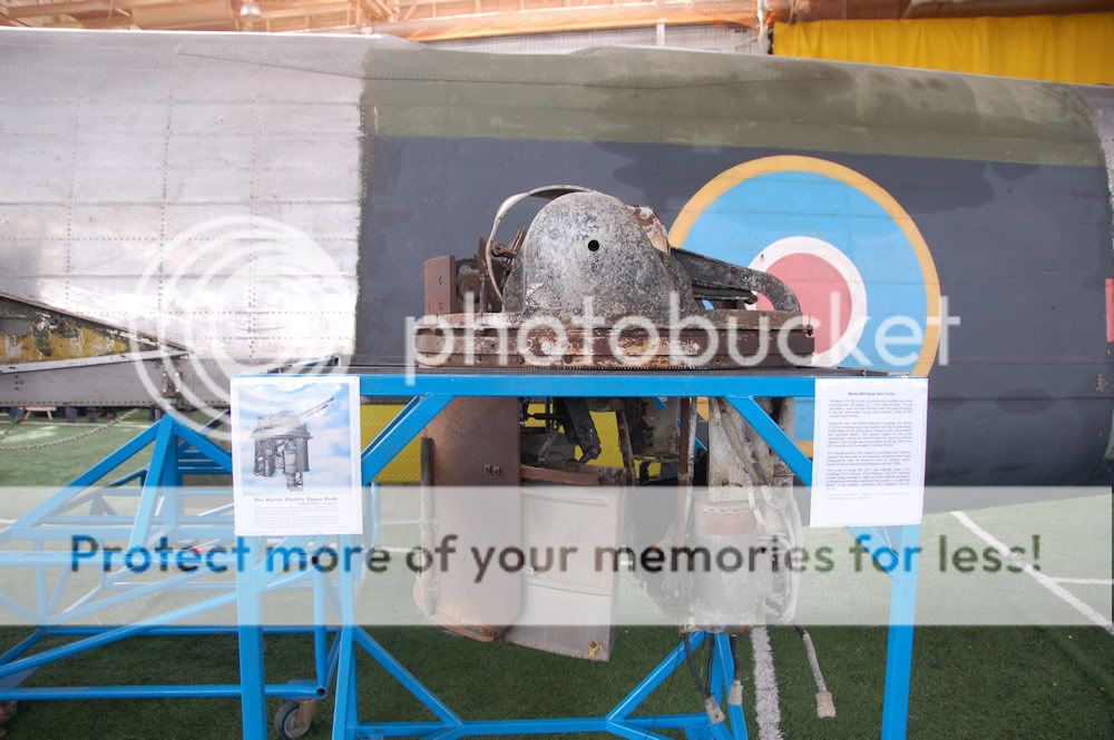

I agree with Mike, It looks like a great start for a Martin top turret project!
By: turretboy - 27th May 2009 at 20:06
Even though it’s been through a fire, spending time in the desert probably slowed corrosion.
It looks like a great start!

Here is another turret project that would be right up your alley. According to the display it is a Martin Model 250CE mid upper turret. It was unfortuately burned in a warehouse fire and then spend a number of years sitting in the California desert. Just needs abit of TLC 🙂
It is to be restored and placed in FM104 ….as she would have lost her turrets many years ago when she was converted for post war duties…

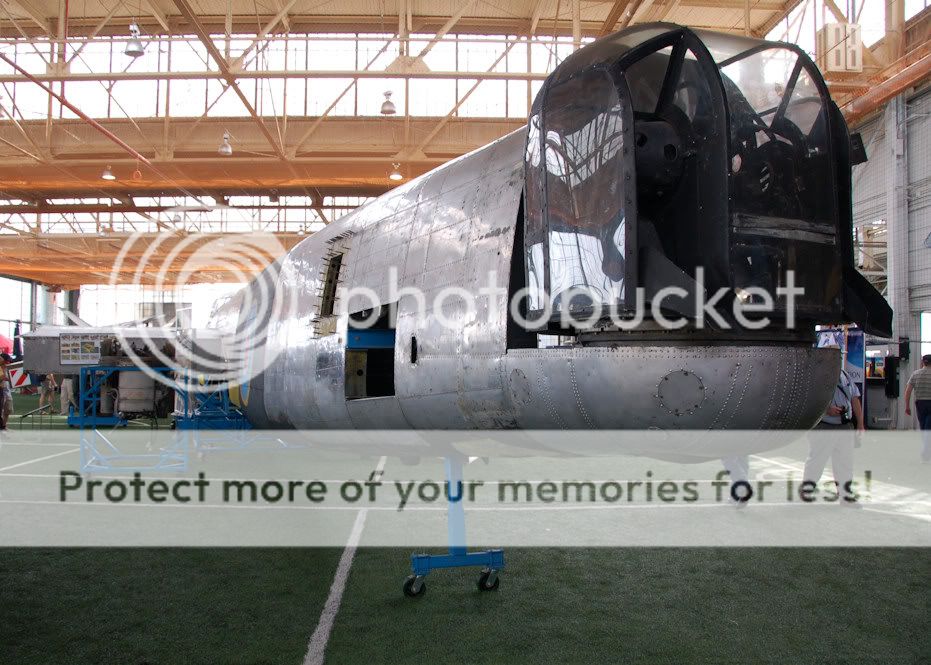

I believe the current nose blister was fabricated for the City of Toronto to replace the original while FM104 was on the pedestal.

Interesting – thanks. No clear-view panel on the nose glazing? Was that normal for Canadian Lancs?
All lancasters had the optical flat bombaiming panel fitted. This might be either a temporary one or one that has not had the hole cut for it?
Andrew, they are great pictures and the ones showing the repairs to the centre section and front spar web are great! Thanks for sharing the pictures!
By: darrenharbar - 27th May 2009 at 12:27
Great to see the effects of restoration on the inside too. Thanks for posting those.
