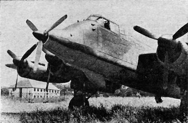

…that B2 in the pic, wasn’t it the one that had either a Python or Dart turboprop mounted in the nose at a later date?.
Greg
The Dart-Lancaster first flew on October 10, 1947, there was also a Mamba-Lancaster (ND784/G) which was converted by Air Service Training Ltd. It was a Mk VI with Merlin 85’s and was originally used to test the A.S.X. motor (?). Apparently 2 Merlins plus the Mamba gave it a speed of 235 mph at 2,000 ft – 30 mph higher than with 4 Merlins. Here she is:
