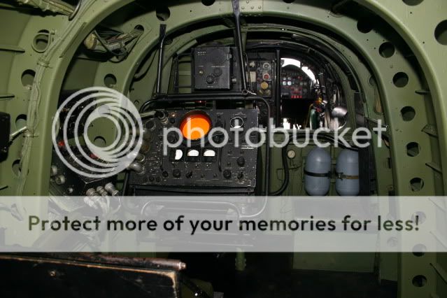

For many years i have thought that Lancasters were fitted with H2S and no later variant.
However, the equipment fitted to Avro Lancaster Mk VII NX611 between the two spars (equipment that we have always thought was Maritime radar) turns out to be H2X.
The equipment hold the reference-
R-78/APS-15A
NXsa-B7733
Any ideas as to whether this was standard equipment fitted to a Mk VII or was it added when the aircraft was overhauled in the 1950’s ready for french service under the Western Union agreement?
There is a photo of the equipment below, it is situated where the rest bunk would be on a Mk I/III-
http://i720.photobucket.com/albums/ww202/nx611_1945/LANCASTER048.jpg

NX611 was fitted withn the American equipment as suggested.
So what bdo we think?
Was NX611 fitted with the equipment for its FE role or when it was taken back for modification for the French Aeronavale service?
Was it originaly built with a rest bunk that was then taken out?
Ive heard that for the ASV in Aeronavale service there was a radar fitted near the rear turret, is this correct? Or do i have my wires crossed, i cant imagine they were talking about AGLT.
We do have an electrical box fitted above the tail spar which i can imagine was used foir the ‘radar’.
Thoughts?

That’s more or less what I thought, although I’ve discussed this with a navigator who used Gee, Loran and H2S on ops, and he didn’t recall ever seeing that style of Gee installation – his recollection was that the Loran/H2S was used by the plotter (who sat at the forward end of the navigator bench). In NX664 it’s fitted on the brackets where H2S (or ASV) would be fitted: http://www.jetphotos.net/viewphoto.php?id=6707714

According to the National Archives the AN/APS-15 (H2X) installation was tested in a Lancaster during the period January to December 1944
http://www.nationalarchives.gov.uk/catalogue/displaycataloguedetails.asp?CATID=7971185&CATLN=6&accessmethod=5
which might mean it could be contemporary with the airframe. Also, – and this is just a thought – if all the aircraft intended for the Far East were fitted with American radios anyway, wouldn’t it make sense to fit them with the American version of H2S – ie H2X as well?.

Yes, sorry – incomplete thought there – I was just heading out. It would be the air to surface vessel radar, so for maritime patrol – hence its location in the back of the aircraft, rather than at the Nav’s position. Incidentally, I suspect the radios in NX611 would originally have been American radios (possibly a Bendix TA-12C and an MR-9B?), and that Loran (AN/APN-4) would have been fitted.
Does anyone have any clear photos showing Loran fitted to Lancasters? The only one I’ve found is of it fitted in the restored NX664, and it seems like it’s not the typical location for it.
