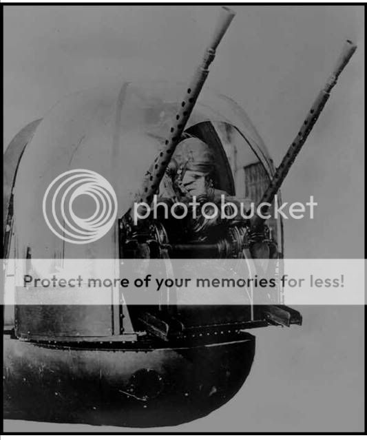

By: nx611_1945 - 18th March 2009 at 19:38
Hi,
This might help, its a rose-rice turret as fitted to 101 sqn lancs. And yes NX611’s is a FN.82, still has 0.5 brownings though.
http://i720.photobucket.com/albums/ww202/nx611_1945/roseturret.jpg
