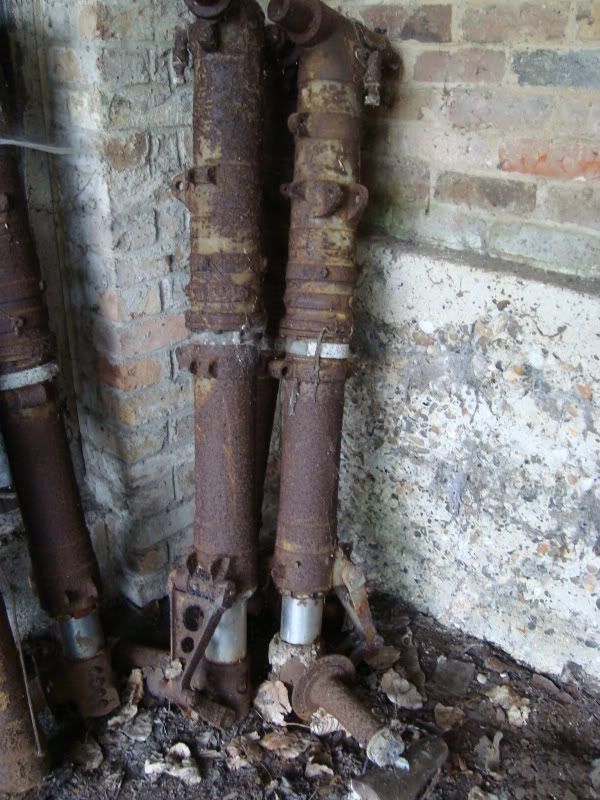

I have been asked by the owner of these items to assist him in finding out what these undercarrige legs and struts are from. His father used to buy bits and bobs from government auctions back in late 1950’s and 60’s But they could be from almost anything. No time to check for numbers unfortunately.
Over to you, the experts! 🙂

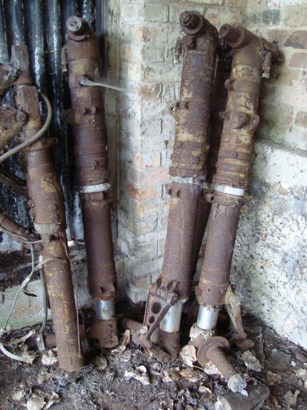

The single legs certainly seems to be Typhoon, check out for a comparison;-
http://www.flickr.com/photos/shnuggy/3122658368/
It’s a 4 bolt axle attachment which again is typically Hawker.
The Tempest has a very different shock absorber design;-
http://www.hawkertempest.se/Undercarriage.htm

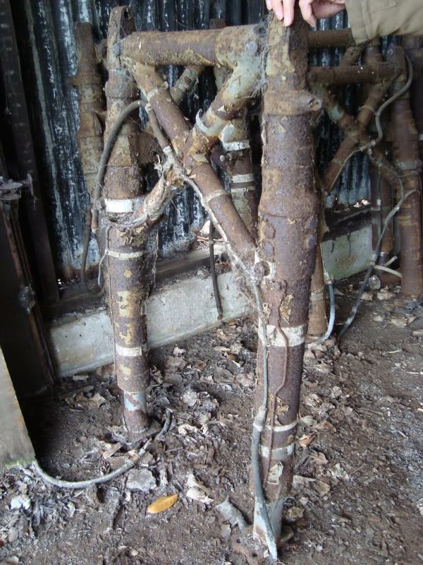

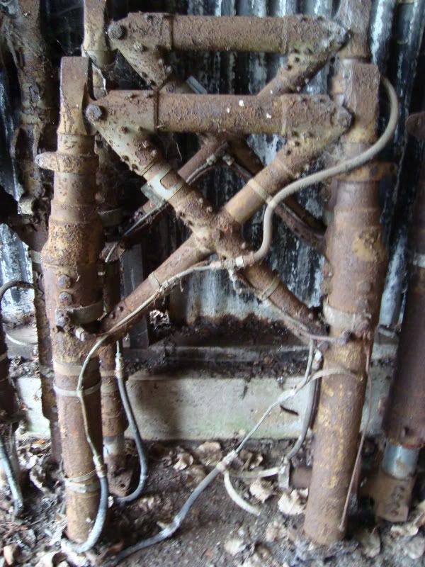

The twin strut, from the attachment pin size of about 20mm, assuming S98 pins (typical for the time) and a landing reaction factor of 2 (again typical for the time) then it equates to a 10 – 20 Ton MTOW – Prefect for Wimpy ….. and maybe some more in this weight class.

This small 3/4 inch wide, 4 inch long label was attached to the double units.
TYPE N0 (BLANK) DRAWING N0 40650 SERIAL N0 (BLANK)
XXXXXX (scratched out) OLEO PNEUMATIC STRUT
This strut contains 1.69 pints of DTD (585 stamped by hand tool) oil when strut is fully extended and carrying no load.
Air pressure should be 665 LBS/Sq In. charge with dry air only. Replace Valve Cap.

Got blitzed by a few people retract that last post the bottom end etc very like Whirlwind but top end does not quite look right as Whirly has casing enclosed at top half.But is it solid or is it a fairing we are trying to establish.

So, we have Wellington confirmed and Hawker Typhoon for the singleton struts.
Now possible Whirwind for the braced units too. Cant beat this forum for ‘identify this’ posts:)

dare I say the twin units with the cross brace do look vaguely like dare I say it Westland Whirlwind .He says mouth salivating profusely !!!!!!!
I may be wrong but any chance of some further detail pictures and any visible numbers ?? And may one have a look at these beast s in the flesh ????

Yep,
Welington & Typhoon
By: Jayce - 17th October 2011 at 18:54
The upper oleos look like Typhoon to me, but the lower is different… or am I thinking of Tempest?
I’m not 100% but I’m pretty sure they’re Typhoon.

Just the single oleos left to ident if anybody has clues.
The owner of these items would part with them if they are useful to a museum or rebuild (static) if possible.

All the details, inc brake pipes and axle plates, etc certainly look right for Wimpey,http://data3.primeportal.net/hangar/howard_mason2/wellington/images/wellington_30_of_42.jpg
http://data3.primeportal.net/hangar/howard_mason2/wellington/images/wellington_31_of_42.jpg
They don’t look that tall in the pics.
Agreed!

Definitely not Oxford, http://www.google.co.uk/imgres?imgurl=http://www.aircraftresourcecenter.com/AWA1/301-400/walk340_Airspeed_Oxford/images_Richard_Eglen/Oxford.JPG&imgrefurl=http://www.aircraftresourcecenter.com/AWA1/301-400/walk340_Airspeed_Oxford/walk340.htm&usg=__j6ugSxJIffVvW-kW5Im_ldRg7zs=&h=524&w=750&sz=62&hl=en&start=2&zoom=1&tbnid=oRS9tQWH47n7nM:&tbnh=99&tbnw=141&ei=_dubTrrKEc_sObCptIkK&prev=/search%3Fq%3Dairspeed%2Boxford%2Bwalkaround%26um%3D1%26hl%3Den%26sa%3DN%26rlz%3D1T4ACAW_enGB337GB337%26tbm%3Disch&um=1&itbs=1
The cross bracing seems quite common for the time.
4ft doesn’t sound much but by the time the oleos are pumped up and the wheels fitted, combined with the fact that the legs look quite short on a Wimpey, there’s no doubt in my mind about them being Wellington,

Looking at photo of Oxford legs here:
http://www.peakdistrictaircrashes.co.uk/pages/lakedistrict/lakesat486.htm
Its a bit different and a little on the small side. Good spot for the cross bracing though!
By: OHOPE - 16th October 2011 at 23:34
For the cross braced units , how about Oxfords ?

Yep plus oleos will be compressed (rear examples fully so by the looks), on Wimpeys the axle supports actually bolt to the squarish ‘pads’ that you see at the bottom.
Looking at pictures of Wellingtons/Vikings/Valettas, the undercarriage legs don’t appear to be that tall anyway.

The leg’s going to look smaller, as the axle end is on the floor which messes with your perception of it. Normally there’s a wheel or a hub on there and it starts about a foot and a half higher.
My bet is still Wellington.

How tall are the twin legs Denis?
All the fittings down to the nuts & bolts are right for Wellington, but kinda see what Hidenburg is saying.
