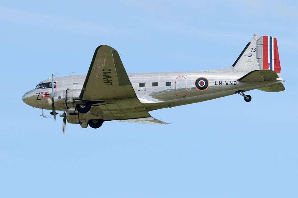

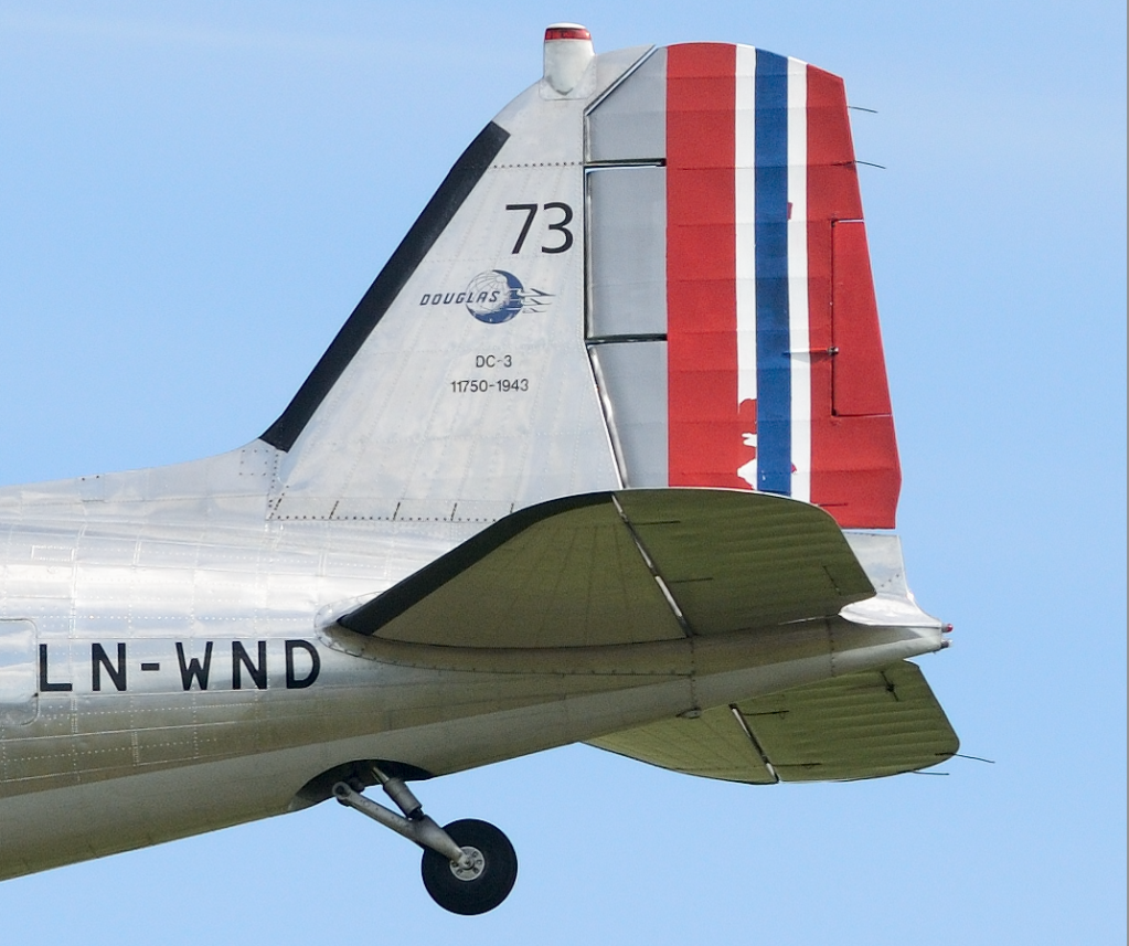

For one thing the CA is visable in a Huge crop, The quality of the image is about right for the quality of the lens, so I guess we should agree to disagree 🙂
Dunno what the point of your quality shots are ??? you can get sharp shots at 1/500th I agree, but in this case the poster hasn’t (In my opinion)
377
By: Jur - 17th July 2012 at 10:13
I would’nt say the Chromatic Aberration is excessive for this lens.
I tend to disagree, as the aberration already is very obvious in a relatively small print. This kind of performance is unacceptable in any modern lens.
Here’s ( http://www.photozone.de/canon-eos/592-tamron70300f456vceosapsc) a review of a Tamron 70-300mm lens. Especially note the positive comments on the level of chromatic aberrations. The performance figures at f/8 and f/11 at the 300m end are almost identical.
Below an example of a good quality 300mm lens at f/8, handheld at 1/500sec.
http://i205.photobucket.com/albums/bb167/Jur_photo/Duxford_0168.jpg
100% detail
http://i205.photobucket.com/albums/bb167/Jur_photo/Schermafbeelding2012-07-17om112403.png
