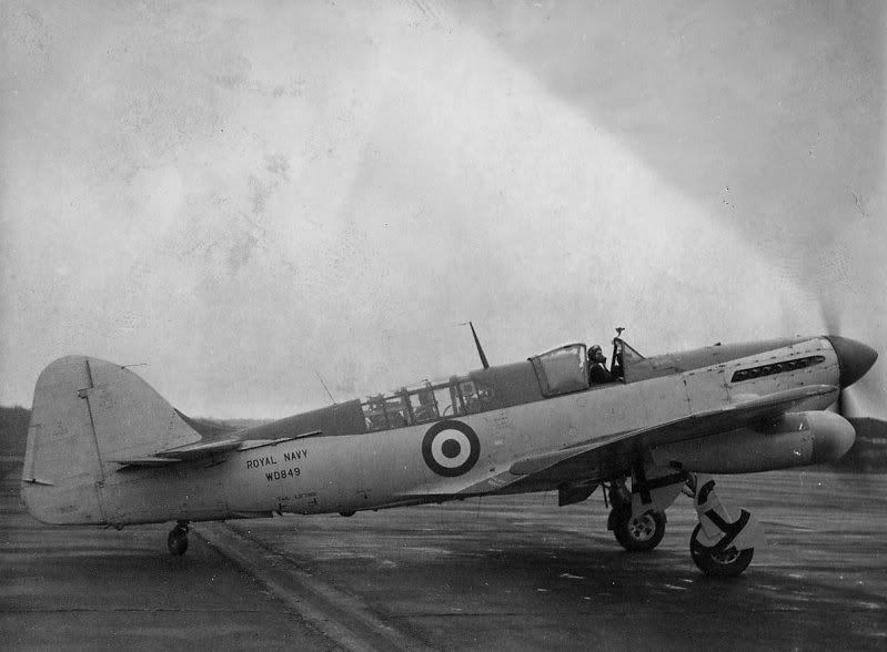

I agree that the wheels look massive compared to the pilots head on that pic, but it looks more “normal” on other pics.
To me it looks as if the wheels are the same size, or slightly bigger than the roundel. I guess that the 11.25″ refers to the width of the tyre in inches, while the 950 (not 900, that was a typo)refers to the height, or diameter of the tyre in millimeters.

Not sure if it helps, but this photo I took at Biggin Hill in 1954 shows a Firefly. Compare the pilot’s head with the size of the wheels – the wheels look massive.
