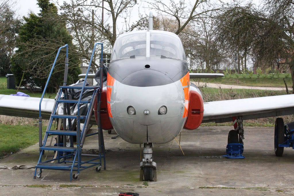

http://i302.photobucket.com/albums/nn93/xn584/Metheringham4.jpg
XS186.

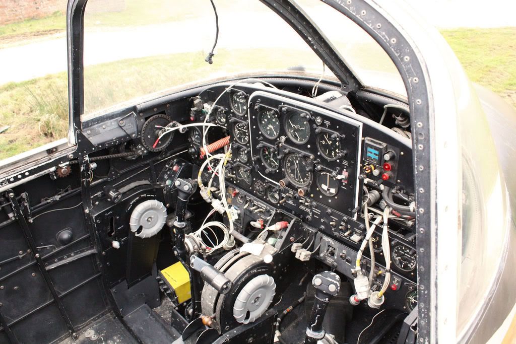

http://i302.photobucket.com/albums/nn93/xn584/Metheringham5.jpg
Cockpit coming on well, with a very high standard of work.

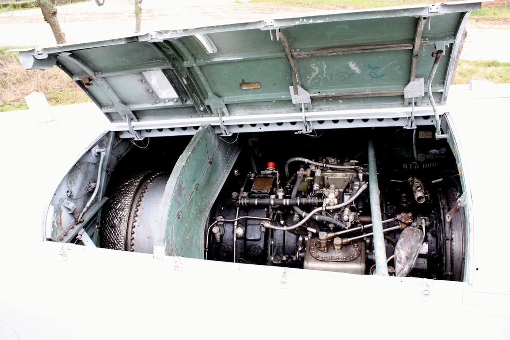

http://i302.photobucket.com/albums/nn93/xn584/Metheringham2.jpg
Just installed Viper engine.

XS186 has been run up on the starter, without ignitors plugged in, all by the book and with support from ‘sooties’ from our local RAF station who have considerable past experience with the JP.
The only reason ignitors have been left off is that we have found some instrumentation problems, including vital oil pressure, and RPM.
Sure these problems will be overcome after some more digging around for replacement gauges. We have tested the oil feed / pressure, sender and tacho generator (and wiring) and they are fine, so we figure it has to be gauges.
As always we take no chances with safety or systems management. Too much hard work compromised, and after six years we are wary of rushing so close to the finish!
If anyone has leads on:
RPM gauge 6A/1054258
OIL PRESSURE gauge 6A/4364327
Any help much appreciated ?
