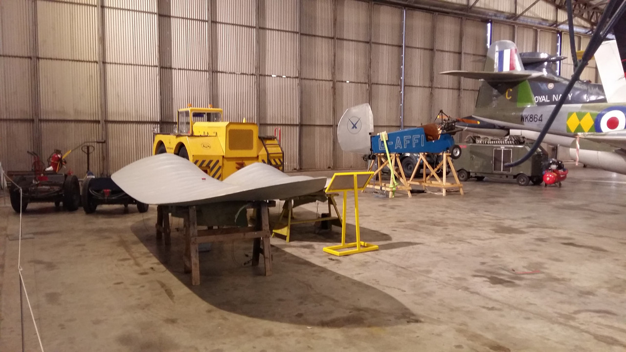

I have some Flea news! Since I got busy with WS788 I have not had chance to pay any attention to G-AFFI sadly. She has been safe in the hangar, tucked away under the wing of the Halifax where, apart from getting some oil dripped on her by the bomber, she was safe.
Now, she has emerged, been de-winged, and is now in the hands of the chaps who run our SE5 and Kitten who are restarting the work to return the little beast to life!
https://i.postimg.cc/fTty9Y1Z/73358307-726626377805142-977831862795763712-n.jpg
I know ‘AFFI gathered a bit of a following on here, so I’ll share what news I can, when I can, from the chaps now seeing to her needs.
