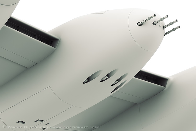

Hi guys, I’ve recently started a new 3D model of the Mosquito FB Mk VI. My first British WW2 subject since I started doing this stuff some 15 years ago! About time! 😀
Since this place is packed with expert eyes, I’d love to hear your feedback. I’m trying to make this one as accurate and realistic as I can, so feel free to be critical.
Here’s the current status of my 3D model:
http://www.digitalaviationart.com/forums/Mosquito/MosquitoFBMkVI_wip07.jpg
http://www.digitalaviationart.com/forums/Mosquito/MosquitoFBMkVI_wip06.jpg
http://www.digitalaviationart.com/forums/Mosquito/MosquitoFBMkVI_wip05.jpg
http://www.digitalaviationart.com/forums/Mosquito/MosquitoFBMkVI_wip03.jpg
http://www.digitalaviationart.com/forums/Mosquito/MosquitoFBMkVI_wip02.jpg
http://www.digitalaviationart.com/forums/Mosquito/MosquitoFBMkVI_wip08.jpg
Currently outstanding are the cockpit area and engine nacelle details, as well as smaller bits and bobs like the tail wheel, trim tab actuators and wing tip light.
If you see any errors, please let me know.
Many thanks!
Ronnie

Thanks Bruce! I’ve poured over AvSpec’s restoration photos for tens if not hundreds of hours and they were a tremendous help in getting my 3D model as accurate and detailed as it is now. The detail changes are a real minefield though and I extensively compared with TA122 and wartime photos, as well as much, much more. My reference folder is currently 3.84 gigabytes and growing daily! 😮

It must be said that Avspecs went to great lengths to recreate a lost mark of aeroplane – the FB26 differs in many ways from the FB6, which is not easy to appreciate until one starts to compare notes.
Anyway, Ronnie’s mossie looks spot on to me – look forward to seeing the next step!

Stan, thanks for the info. I did indeed put these items apart in case I do a KA114. The detail changes for Mosquitoes are so many it’s very hard to figure out what’s “correct” unless you have detailed photos of the subject at time of service. My first subject is a 418 Sqn intruder which had exhaust shrouds, a whip aerial, 50-gallon droptanks, carburettor shrouds and no drive-in panel in the canopy hatch. I’ve assumed the rounder tail light fairing Bruce suggested. Canopy framing differs in detail too from KA114. For the canopy alone there are a dozen variations depending on mark, role, prodcution date/factory/country/etc… It’s a maze.

For your info. KA114 is Canadian built. The tail light fairing is an original part as are the tailplane fairings. The fairings have been reskinned and it was my son who did most of the “Skinbashing” on the aircraft.
