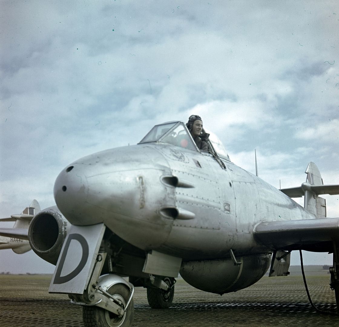

More information of where the pictures were taken and the circumstances might throw some light on the type of aircraft although a Meteor nose wheel seems to fit the bill.

Yes the photo is a Mk IV

Fair point. It would be an early one then.

Meteor nose wheel tyre.
https://hosting.photobucket.com/albums/ii120/Duggy009/Duggy009-1/.highres/Duxford-Gloster%20Meteor%20MK4-7.jpg?width=1920&height=1080&fit=bounds

Chunky tyre tread for a nose wheel?

After thinking about it more I believe its a good match for a Meteor nose leg fork, the main is similar but beefier.
