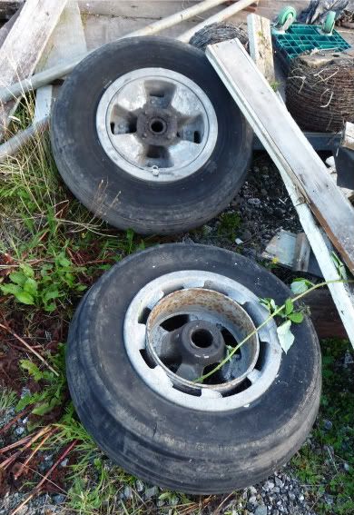

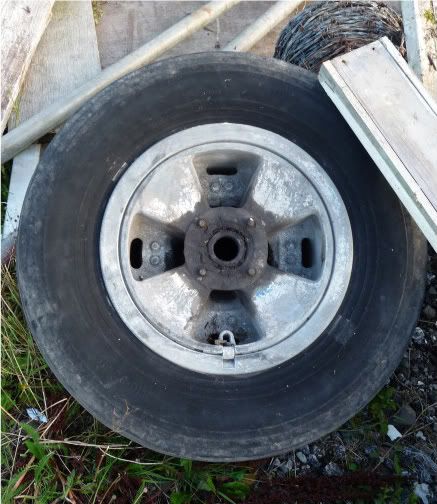

I recently came across the two wheels pictured below at a non aviation location, Any help in identifing them would be greatly appreciated:)
The only info I could find on the hub was :-
Drg Nos.AH8208 issue 7 & Serial Nos. 79695/7
And the tyre size is 32x10x15

By: pagen01 - 8th December 2009 at 05:00
I found four of those wheels on a working trailer at Llandow last year…
Here they are, forth one out of shot.

WOW many thanks for the replies folks, I think they came from RAF Woodvale nr Southport which makes them possibly off a Barracuda as i know they where based for a short while whilst a RNAS.
Sadly the wheels are presently in the hands of a man who intends to put them on a trailer of some sort, but I’m sure he would consider passing them on for the price of some other replacement wheels.
If anyone would like to contact him regarding these then I’d be happy to pass on his phone number via a PM.

By: TempestV - 23rd November 2009 at 13:31
Could it not be that 8379 just superceded 8208, apart from the valve hole being relocted there dosen’t seem to be much difference.
I think they are interchangable.
9,672
By: pagen01 - 23rd November 2009 at 12:41
Definitely in the Sea Fury parts list, I checked it this morning.
532
By: Bograt - 23rd November 2009 at 12:15

By: TempestV - 23rd November 2009 at 10:26
Sea Fury as well…….
Similar looking to the Sea Fury, but I believe these used the AH8379 in common with the Sea Hornet.
The main visual difference is the addition of the hole in one of the spokes.

1,411
By: TempestV - 23rd November 2009 at 07:56
Hiya Folks,
They look like DH Vampire main wheel tyres to me…maybe from a T.11!

9,672
By: pagen01 - 23rd November 2009 at 07:54
I found four of those wheels on a working trailer at Llandow last year, complete with backing plates and hubs etc. Apparently the trailer came from a farm near St Davids, so wondered if they were from a Sea Hornet, but err’d on the side of Firefly.

By: David Burke - 22nd November 2009 at 19:43
Mark 12 was bang on the money from the hallowed pages of the Dunlop wheels list!

1,411
By: TempestV - 22nd November 2009 at 19:07
AH8208
As Mark 12 says.
Negative G – are these available to a good home? 😀

9,127
By: Mark12 - 22nd November 2009 at 19:02
Not de Havilland Hornet by any chance, where’s DC when you need him!?
Hornet, Tempest, Barracuda, Firebrand, Meteor and Firefly…marks specific.

By: darnsarf - 22nd November 2009 at 17:26
They bear a resemblance to 4-spoke Spitfire wheels, e.g. –
