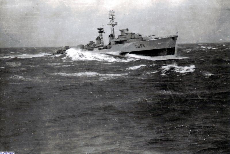

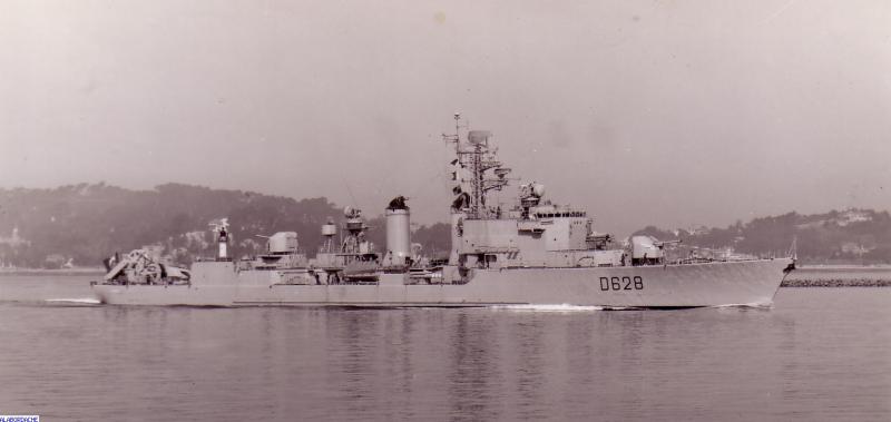

And in honor of its sterling Cold War service:
Indian Ocean (1960s?), in its original AA configuration

After a thorough anti-submarine refit (1980s?)
http://www.alabordache.fr/marine/espacemarine/photo/image/vignettegvauquelin6377.jpg
