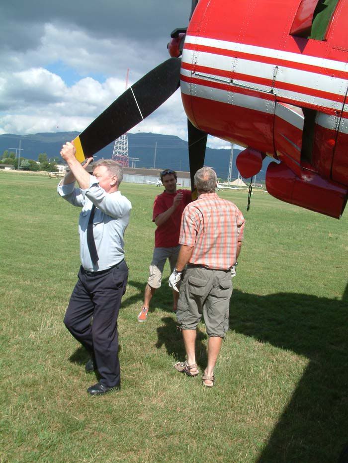

Just to clarify yes An2 is four blade.With the prop in a x configuration when static we attach a “top hat” to the oil drain (just visible in pic in front of oil cooler) which stops accumalation in the bottom cylinders.Before EACH start we then pull blades through to check that there is not a hydraulic lock before closing the oil drain valve.Great as a parking marker because any oil that misses the top hat kills the grass below!When people see us prop pushing the stock answer when asked what we are doing is… “winding up the elastic band!”

By: l.garey - 7th May 2011 at 07:49
Re post 14 by AN2grahame:
Like this? AN2 YL-LEI at Prangins June 2009
