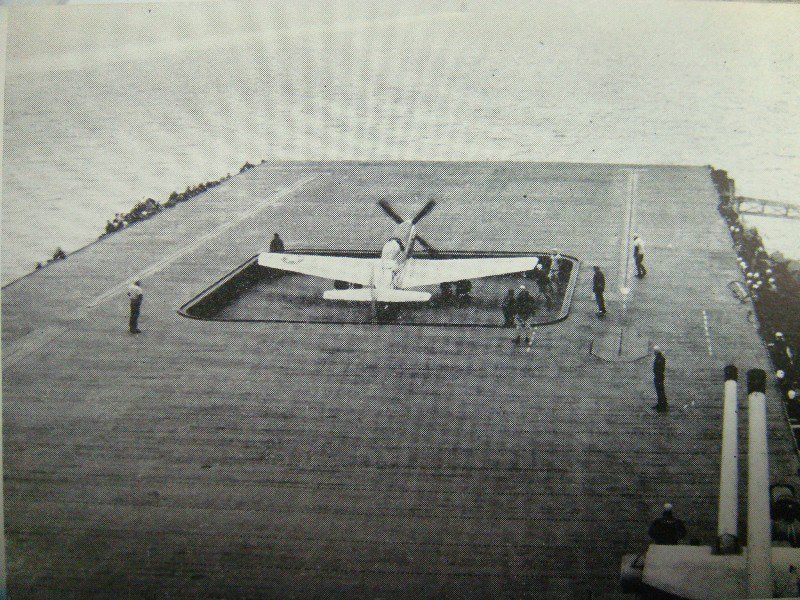

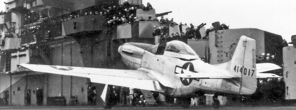

There was only one P-51D that was used for carrier trials. The program, conducted by the SEU (Ship Experimental Unit) saw P-51D-5-NA, 44-14017, borrowed by the Navy in the Fall of 1944 and modified with the addition of a tail hook, as well as a holdback bar/lasso at the base of the tail and a pendant-type hook at the base of the firewall, for use with the catapult launch system. Bob Elder, who headed the project, made 150 land-based arrested landings and an untold number of land-based catapult launches. (These land-based trials were done at Mustin Field NAS, which unfortunately isn’t around any more.) On November 15, 1944, Bob Elder made 4 landings and 4 deck-run takeoffs from the USS Shangri-La, near the Virginia Capes – a total of 25 landings and takeoffs were made on the Shangri-La in all, all of which were reported to be completely successful. (At this same time, the SEU was also doing similar trials with a B-25H and an early F7F Tigercat.) The aircraft never officially entered Navy inventory, and contrary to myths derived years ago (and repeated numerous times since), the aircraft never had a change in designation or BuNo. assigned. The aircraft later was provided to the NACA (forerunner to NASA) and became NACA 102 (not NACA 127, the one flying today, but there has been some rumors over the years that the tail of the Navy modified P-51D/NACA 102 ended up being fitted to NACA 127).
As Bob Elder noted, the bulkhead that the tail hook was fitted to started to receive some cracking after making arrested landings at 90 mph or more (this was found while still earlier in the testing, back at Mustin Field), and so they had to land slower than 90 – lateral control became unmanageable below 82 mph, the rudder being to the full right stop by this point. As a result, Elder made all of the approaches at 85 mph. This was no problem for him, with the experience he had, but for novice pilots that would have been a problem. Landing the aircraft required a constant curved approach, not unlike what was required with the Corsair, however Elder mentioned that the visibility over/around the nose was worse on the Hellcat and Corsair than it was on the Mustang.
The capture of Iwo Jima in early 1945 eliminated the need for carrier-based Mustangs.
All of the photos showing fleets of Mustangs on carriers are/were from deployments, with the carriers simply serving as cargo-carriers from one land base to another.
Here are a few more photos of 44-14017 aboard the USS Shangri-La, not seen on the linked webpage.
