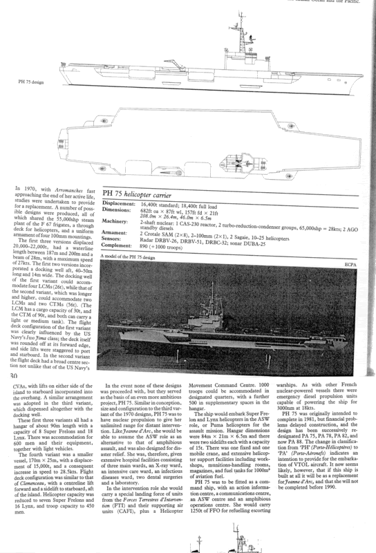

By: Bager1968 - 7th April 2009 at 02:34
Conway’s 1947-1982:
sorry its so small, but the text is substantially that posted by Karakris
By: Karakris - 6th April 2009 at 21:10
PA75 – PH 75 Carrier — Information
Dear Sirs
Please find Attached — A Document containing the Information which I have on the PA75 / PH75 Aircraft Carrier Concept of the 1970’s
Regards
Karakris

By: Peter G - 24th February 2005 at 09:38
PH 75
Cannot directly help but the concept before PA 75 was the PH 75, which is probably very similar.
PH is Porte-Helicopteres
PA or Porte-Aeronafs would have carried VTOL aircraft
PH 75 would have entered service in 1981.
18,400tonne full load (16400 standard), length 682ft (208m) beam 86ft (26.4m),
Nuclear reactor with 2 shafts (65000 shp). Range on emergency diesels would have been 3000 nm for 18 knots.
Armament: 2 Crotale SAM, 4 Model 1968 100mm
Radars: DRBV 26, DRBV 51, DRBC 32
Sonar: DUBA 25
890 crew plus 1000 troops (further 500 in some hanger space)
10-25 helicopters
Role was amphibious assault (Puma) with secondary ASW (Lynx, Super Frelon) . Hanger was 84 x 21 x 4.5 metres. Lifts were 15 t.
Carried 1000 m3 of aviation fuel and 1250 t FFO to refuel escorts.
