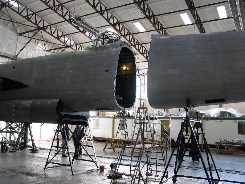

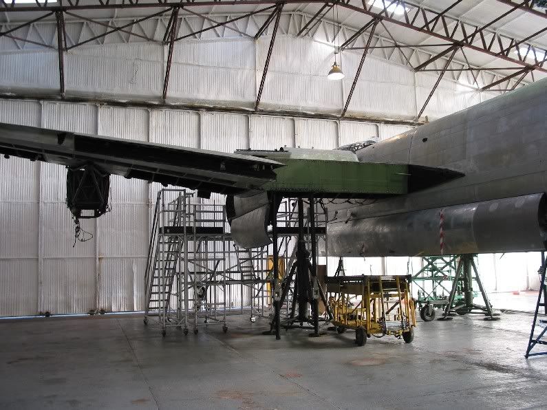

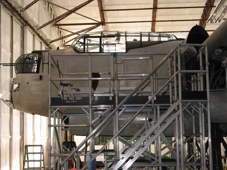

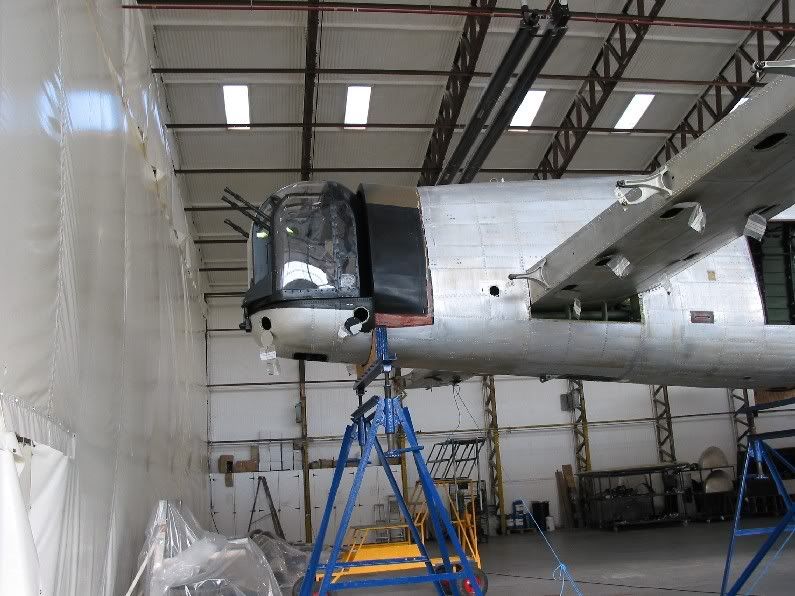

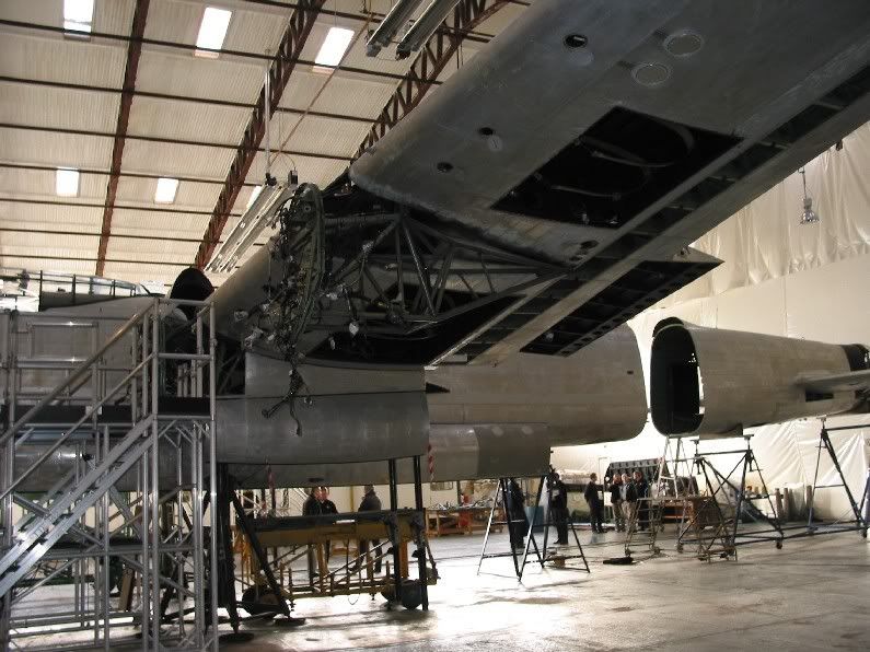

The BBMF Lancaster is doing well at Coventry with Air Atlantique and Classic Aircraft Maintenance carrying out the maintenance. The inspections have been completed and the aircraft is in good condition. We are now entering the rectification phase with painting scheduled to begin in Feb 07. All the control rods are being replaced, hence the aircraft being split at the tail section to enable their removal.
All the BBMF engineers are busy at this time of year carrying out the annual maintenance on the rest of the fleet at Coningsby. They are not scaled in manpower to carry out maintenance to this depth.
It is policy to contract out the larger maintenance operations such as the Dakota, Lancaster, Spitfire, Hurricane and Chipmunk major servicings. This allows a second set of eyes to check the aircraft and acts as a quality audit.
The BBMF participation after the aircraft enters the civilian contractor is minimal, being limited to attendance at progress meetings carried out every 20 working days.
Air Atlantique previously carried out the minor maintenance on the BBMF Dakota.
The major rectification carried out during this maintenance has been:
Flap control tube replacement
Control rod replacement

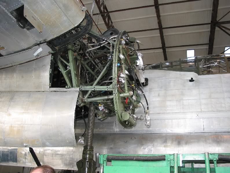

Engine subframe repair

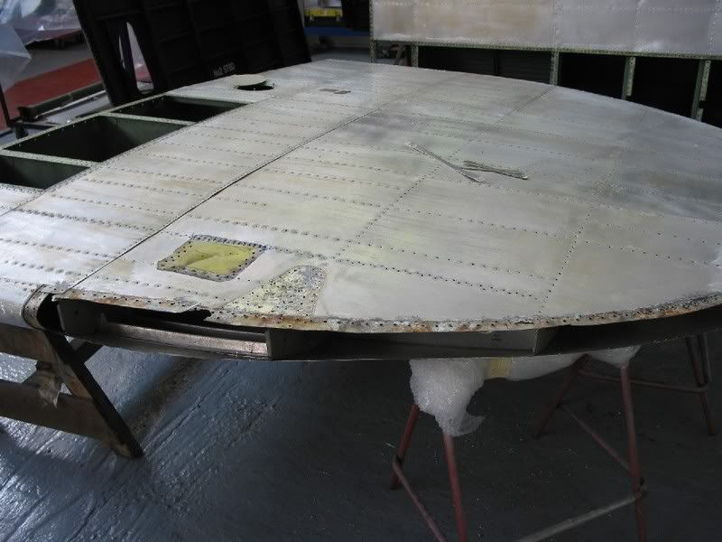

Various skin repairs due to minor corrosion
Undercarriage assembly repair
Fuel tank repairs
Wing boom inspection and NDT by BAeS
All work is in-hand and in line with the project plan.

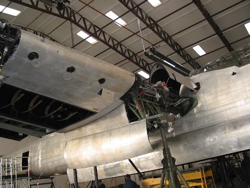

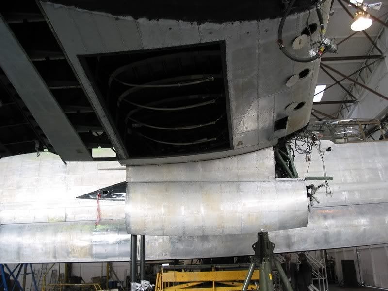

Engine subframe removed for repair and further NDT inspection
http://i130.photobucket.com/albums/p274/rum_monster/day60bearers.jpg
Corrosion found on the stbd wingtip. The skin is being replaced.
http://i130.photobucket.com/albums/p274/rum_monster/day60LEcorrosion.jpg

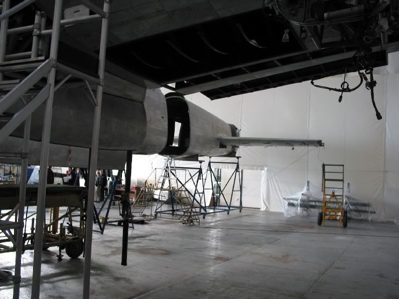

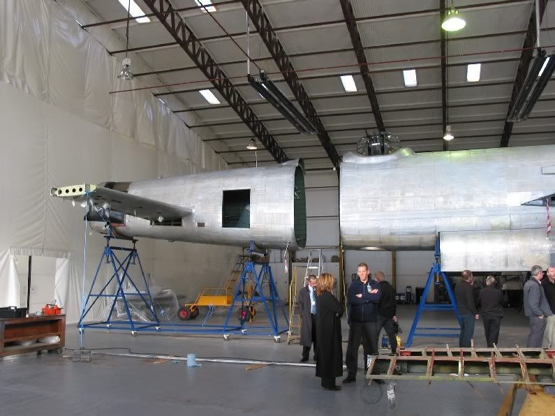

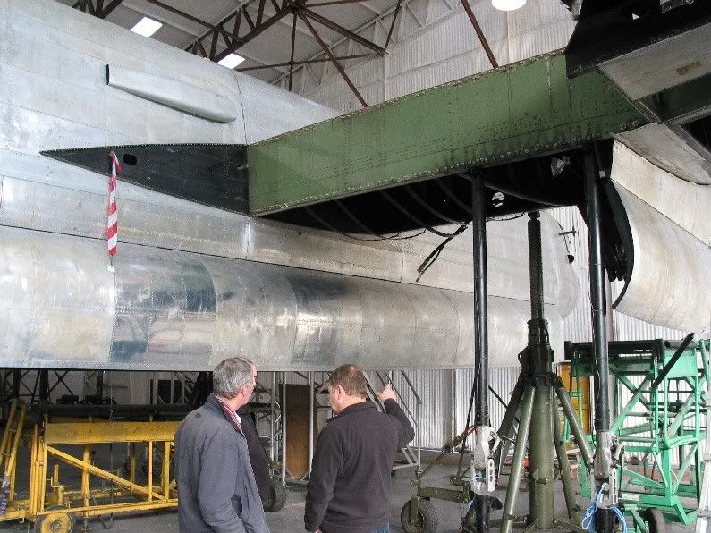

Tail section back together after control rod replacement
http://i130.photobucket.com/albums/p274/rum_monster/day60rear.jpg
Day 60. Engine subframes removed
http://i130.photobucket.com/albums/p274/rum_monster/Day60RHS.jpg

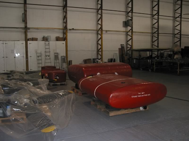

Fuel tank bay
http://i130.photobucket.com/albums/p274/rum_monster/day60tanks.jpg
Oil and Fuel Tanks post bay maintenance
http://i130.photobucket.com/albums/p274/rum_monster/oilandfueltanks.jpg

http://i130.photobucket.com/albums/p274/rum_monster/split.jpg

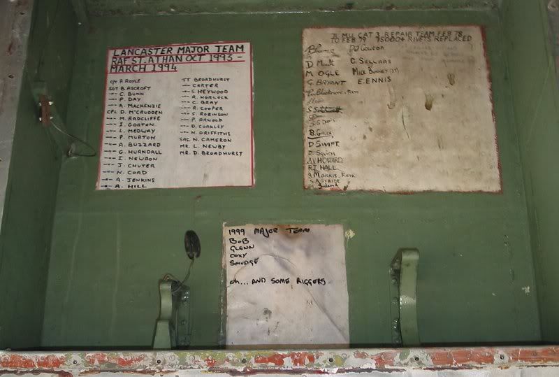

During winter servicing at Coningsby in 1978 a few rivets had popped on the port flap. On replacing them a few more surrounding let go. On closer inspection many more magnesium rivets were found to have failed or were about to fail. It soon became obvious that the work was beyond the resources of the BBMF and teams were called in from No. 71 MU at Abingdon. The aircraft was grounded for eighteen months whilst repairs were made but this was only the start of the work carried out by 71 MU.
“Cat 3” was the fact that the work was beyond unit resources and not because it was involved in an accident.

It was carred out by Sprayavia. I am not sure what they used but it didn’t take very long. What surprised me with this project was all the tasks that looked difficult on paper actually worked out to be relatively straight forward in execution, such as splitting the fuselage, removing and replacing control rods to name but a few. It took over a year to plan the maintenance and what and how we were going to approach each tasks. At this stage, prior planning seems to have paid dividends. There is still a lot of work to be done as the rectification, reassembly and painting phase begins.

Re. the rivets, the Lanc spent all of 1978 on the ground, due to extensive wing rivet corrosion.

Nice photos. Interesting comment on one of the bits of paper about 74,004 rivets being replaced.
yes excellent photos. I thought the rivet replacement comment was interesting too. Why a ‘Cat 3 repair’ was she pranged at some point or was it just a serious case of ‘Irish Woodworm’:D Just curious.
