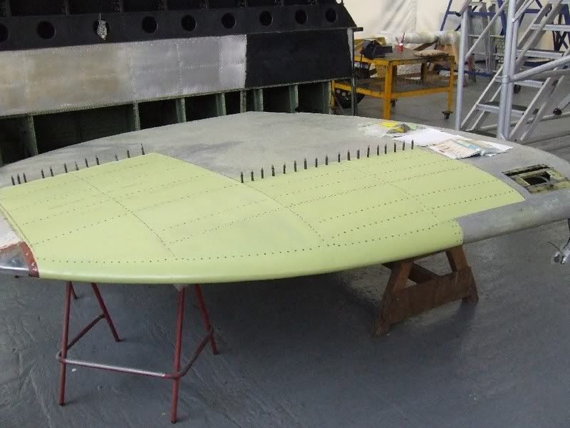

Wing tip back on
http://i130.photobucket.com/albums/p274/rum_monster/wingtipSM.jpg

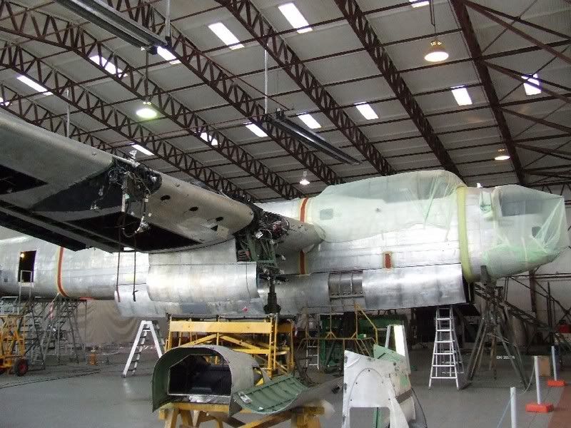

Side view
http://i130.photobucket.com/albums/p274/rum_monster/SideSM.jpg

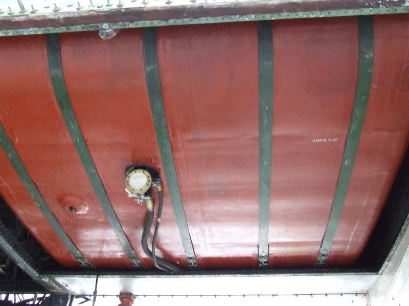

Fuel tank in place
http://i130.photobucket.com/albums/p274/rum_monster/fueltankSM.jpg

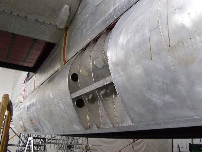

Bomb Bay door skin to be replaced
http://i130.photobucket.com/albums/p274/rum_monster/bomdoorSM.jpg

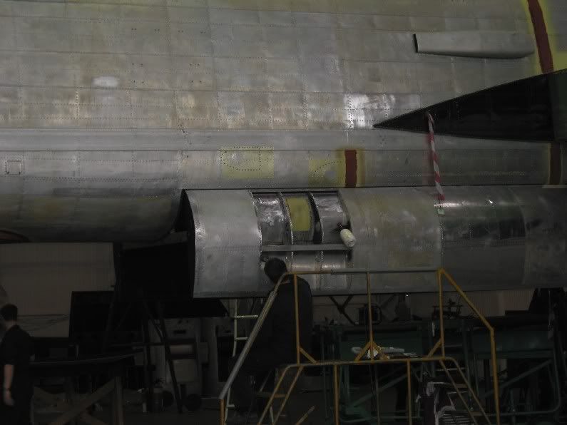

Wingtip skin repair
http://i130.photobucket.com/albums/p274/rum_monster/wingtip_repair.jpg

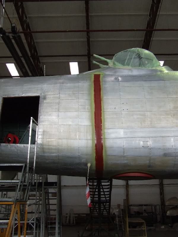

Fuselage break point fabric applied
http://i130.photobucket.com/albums/p274/rum_monster/split-1.jpg

Bomb bay door skin replacement. An APU used to be fitted in the bomb bay. The steel strengthening plate was removed and skin replaced.
http://i130.photobucket.com/albums/p274/rum_monster/bombdoorrepair.jpg

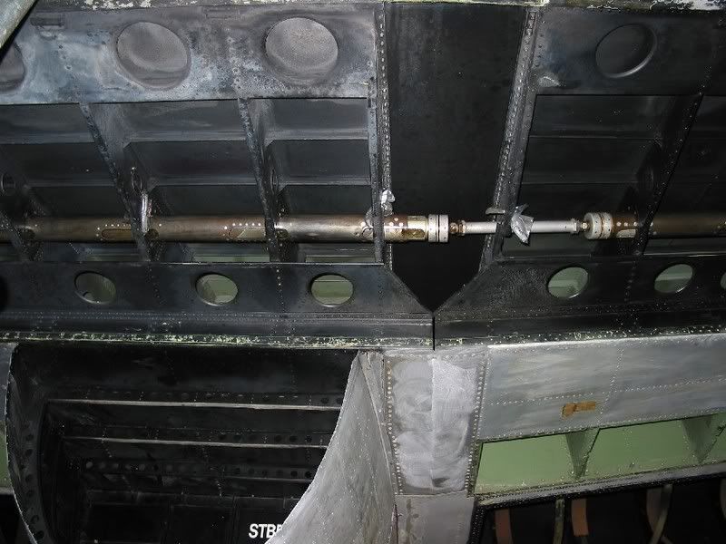

The flap control tubes which need to be replaced due to cracking and corrosion.
http://i130.photobucket.com/albums/p274/rum_monster/Flapcontroltubes.jpg
The control rods after removal from the aircraft.
http://i130.photobucket.com/albums/p274/rum_monster/rods.jpg

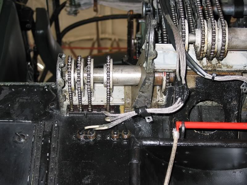

The engine control mechanism
http://i130.photobucket.com/albums/p274/rum_monster/ecucontrol.jpg

So how long do we have to wait before the repainting commences on PA474 at Coventry?
Most of the aircraft should be back together by the end of this month. The engines are being delivered next week. We are waiting on the manufacture of the flap tubes. This is the critical path as the painting won’t take place until the flap tubes are in and the wing has been reassembled. This is scheduled for the end March, beginning April and will take approx 10 days.

By: Fluffy - 31st January 2007 at 20:35
It’s the inside of the bomb door!

By: Bluebird Mike - 29th January 2007 at 22:26
Do I get put out of my baffled misery re. the mystery photo yet? Huh huh huh? Pretty please?! :confused:

By: Bluebird Mike - 26th January 2007 at 21:17
No guess on the piccy yet where are all the Lanc experts
I made a guess earlier! Wondered if that big hole was an area where the flap tubes passed through?
