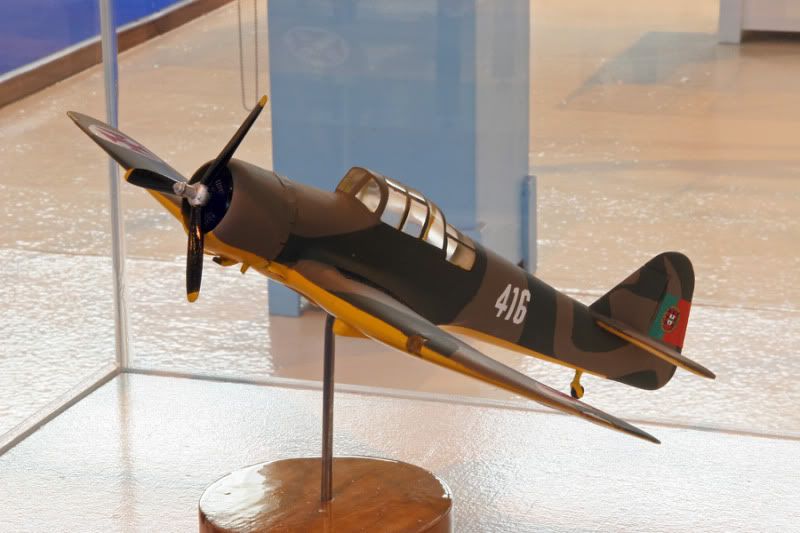

Whilst not a Martinet, I thought you might be interested in this model of a Portuguese Miles Master which I found in the museum at Alverca last week.
Tim
