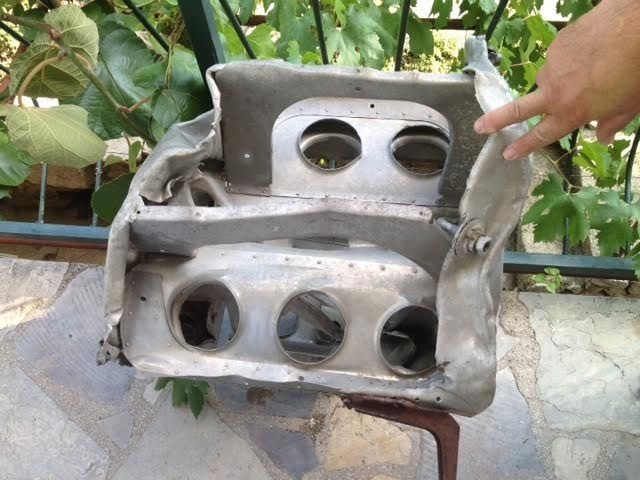

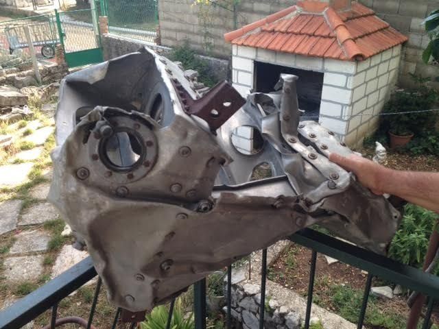

I am posting this for a good friend, who in turn is trying to find information for a friend.
Here is his message to me
‘ I have a mystery to solve. At the bottom of the black cloud of smoke in the attached photograph, is a Bristol Beaufighter. The bad new is that it contained my mate, Jonathan’s grandfather. Even worse, he was killed a couple of months before Jons’ father was born.
A couple of years ago, a lump of wreckage was found near the ruins of the power station, and Jons’ family are understandably keen to find out if it is from his grandfathers’ aircraft. The bodies were recovered and are in a known war grave in Belgrade. Jons’ dad is off on a pilgrimage there soon, and wants to close a few chapters on his past.’
I have the photos and before anyone asks, no one has seen part numbers. The people who have the piece are going to look, but there is nothing to report at the moment. I was just wondering if anyone would recognise it.

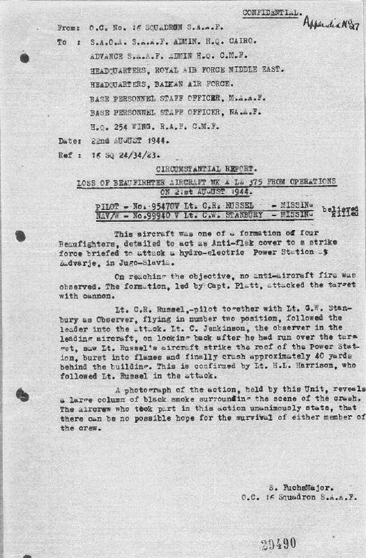

the report
http://i28.photobucket.com/albums/c233/Melvynhiscock/2_zpso2ohtqu2.jpg

So, does anyone recognise this as Beaufighter?

I thought Bristol tanks were welded?
Slipped my thoughts, you are quite correct.

I concur that it is a fuel tank, but don’t recognise it. There would have to be a spray of metal from the disintegrating aircraft in the hill behind the station, no doubt over the years working its way down to the river below. Perhaps a bit of work with a metal detector might come up with small pieces that haven’t been scrapped.

By: Beaufighter VI - 4th May 2016 at 22:38
Beaufighter wing tanks are strapped to the tank bay door, no steel attachment. This tank has more of a Hawker feel to it, similar to Hurricane wing tank with that right angled steel mount.

The serial is on the document – LZ375, a Beaufighter TF-X.

Hi Melvyn,
That “Lump” looks WW2 ,british to me and also looks like part of an integral fuel tank. You can see 3 fuel connections, 1) the large reinforced pipe attachment ring. 2) what looks like a “Stack ” or vent pipe connection and 3) poss another connector that the mans hands are covering in the one pic. (The pics can be seen if you click away and get into photo Bucket. ) My knowledge of Beaufighters is less than yours, but plenty of folks in here will pick up on having an ID for this. Have a look at any bolts, nuts, connectors to ID anything British. Hope it is Beaufighter, for families closure.
