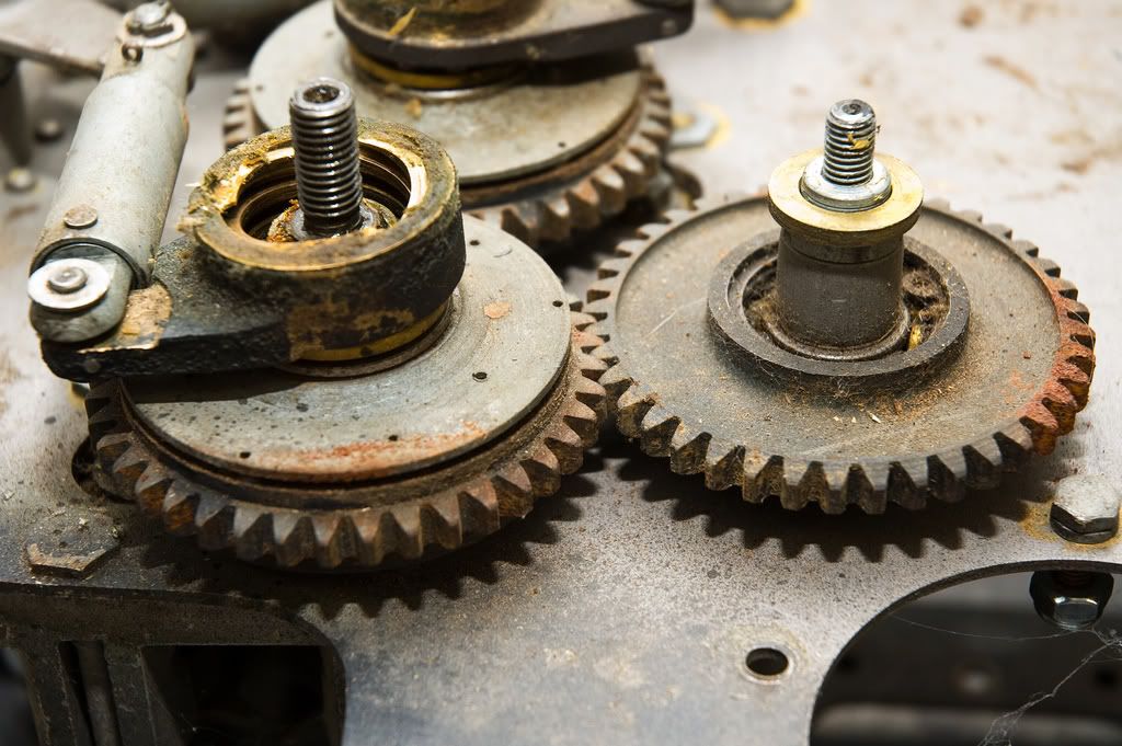

Any recommendations on how to preserve bare metal gears that operate without lubrication?
All parts have been dismantled and blasted.

By: ZRX61 - 16th November 2008 at 16:12
Electrolysis is your friend.
