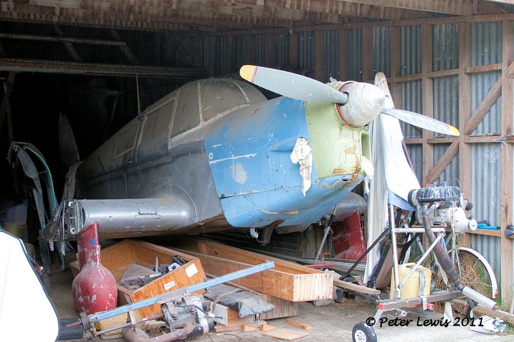

ZK-AQK has been bought by the Ashburton Aviation Museum where we will restore her for exhibition.
But first we must move her from Rangitata to Ashburton which will most likely be done by truck and we need to do this soon.
Can anyone please help with advice regarding lifting points? Lifting at the wing attachments using a spreader bar? Sling around the engine mounts? I assume there are ‘official’ lifting points on these aircraft?
Thanks.
John, you need to lift using a minimum 150 mm 6 inch wide strop both front and behind the wing centre section to spread the load. We removed the U/C wheels complete and sat the legs on the forks in extensions to the trailer bed to accommodate the wheel base which as you know is quite wide. Not sure of the distance between Rangitata to Ashburton, towing her backwards on her U/C could be a possibility?
In our experience moving Proctors across Europe this was best done at night and the early hours. I am not aware of any official lifting points (only jacking points) we used a photo reference of a Mk V being lifted via a sling dock side into a ships hold for export to Australia in 1949 for our inspiration. Good luck, but why not consider a rebuild to flight instead of a museum piece?

639
By: flyernzl - 3rd March 2014 at 23:31
I saw it a couple of years ago.
Looks complete, but pretty rough. Would need a total rebuild.
Last flown in 1965.
http://i104.photobucket.com/albums/m169/flyernzl/Percival/ZK-AQK_IMG_8386-Edit_zpse076aaa1.jpg
