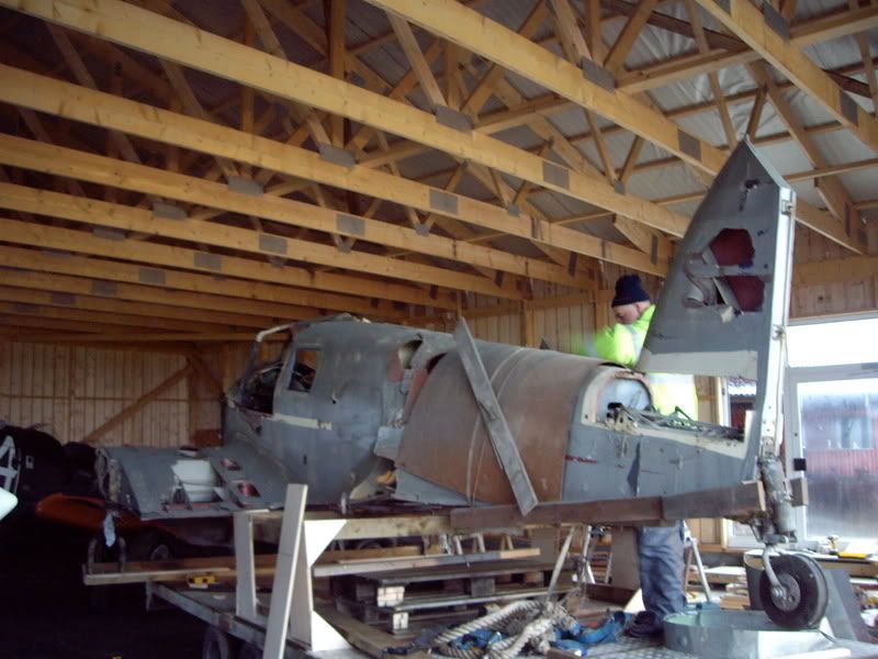

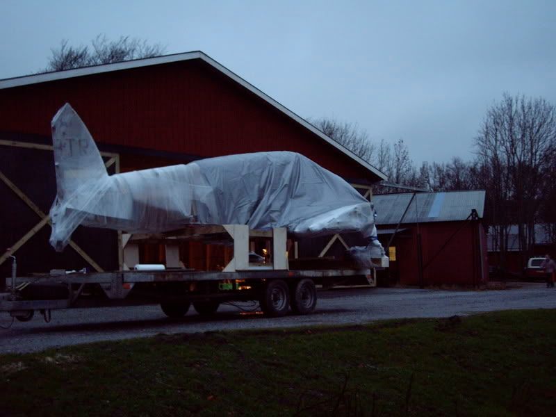

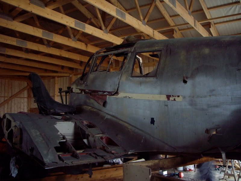

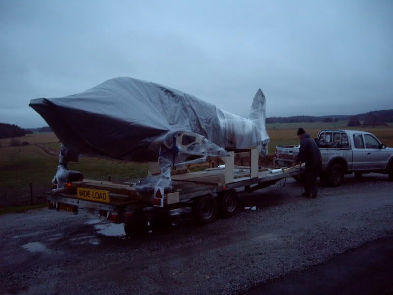

These pictures show Mk 3 G-AKEX loaded in Sweden on the 5th November, and almost ready to roll for home. The wings, stabiliser , elevator and rudder were all shrink wrapped, and carefully positioned below the airframe. between sheets of four inch foam. The complete fuselage was also shrink wrapped, and covered with tarpaulins, all taped and lashed down securely. Cowels etc are piled inside, and the doors re fitted and locked to keep everything safe inside. Due to the width of the center section, at 11 ft, the hubs were unbolted, and the u/c forks set on to a hefty wooden beam, then bolted into place. Engine and prop are secure in the pick up, well covered and oiled. The wheels and tyres remain attached via the brake cables and will be fitted in England, in the hope they may be persuaded to take air again, which will facilitate moving the airframe into store. An escort van has accompanied the load to Gothenberg and she sails for Immingham arriving in the early hours of Saturday the 8th. More interesting history is being revealed, with large areas of metallic blue on the fin, not RAF fin markings, as they can be seen below this paint. I have now seen the form 78 detailing her RAF history, and it appears she was based mainly at Thame and Shrewsbury on communications duties. In Nov 43 she suffered a Cat B accident, and was in the repair shop for over four months. Tellingly the initials FA appear alongside the Cat B entry, i am told this likely was an abbreviation for Fatal!, can anyone out there confirm this a likely explanation. More pictures to follow as soon as she is home to Suffolk, and a real inspection can be started on this rare survivor. 😀

Pleased to report that KEX is back safely on home soil, after her 57 year absence.
we unloaded her early hours last Saturday, and she is tucked away in her
storage building until spring 08, when things will start to happen.
Looking inside the port wing revealed a bemused Swedish mouse, who scarpered off further inside the wing, i trust he will escape and make friends with the locals! Good news is that the condition of the woodwork is better then initially thought, and professional opinion has been expressed and that as much as 85% could possibly be retained in the re build! Will post more pictures soon
