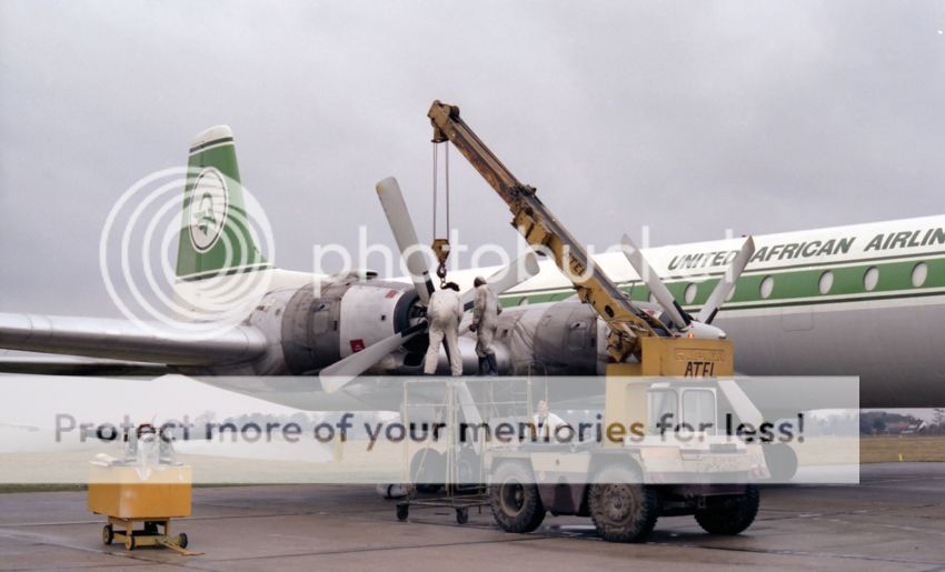

Sorry not much help, but by coincidence I was editing this photo last night.
I seem to remember that the kit was quite large and included a torque multiplier that was required to break the nut, there was also a sling for the dome, which is quite heavy! Those guys at Bournemouth must have the tooling!
http://i457.photobucket.com/albums/qq293/Jetmech_photos/img459NegQ4-CL44-5A-DHJ-Stn-29Jan82sml_zpsf052d6bb.jpg
