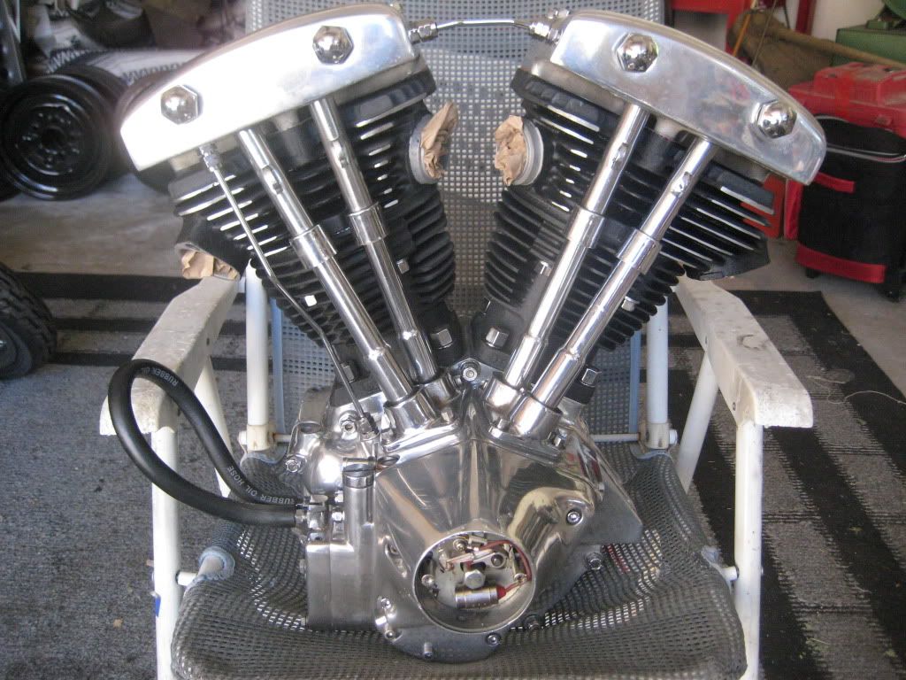

I suspect it’s more of an air flow reason Jim – my Harley-Davidson has the same 1930s hemispherical combustion chamber design as found on radials, but the valves are convex on the intake, flat on the exhaust!
Come to think of it, the old Shovelhead does look like a slice from a radial…
