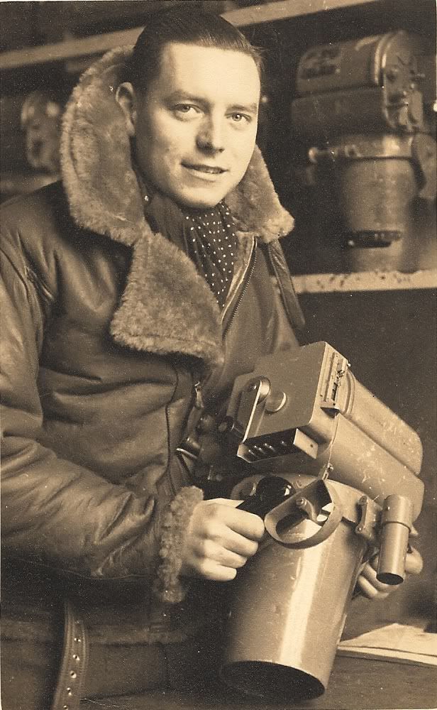

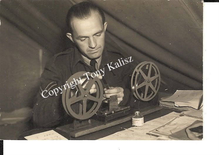

By: Bob - 3rd October 2010 at 00:24
Great pics. In the first he’s obviously checking 16mm film (that was used in the gun cameras). Pot of film cement on the table so he could be joining film or removing segments (the good bits maybe!)…
As you say, great workshop!
The Spitfire image – little bit ‘spooky’ that one of the few Spitfires I’ve seen with the camera port still extant is Spitfire Mk.Vb BM597, which is marked up in 317 Sqdn ‘colours’!
The last pic – that looks like a hand held recce camera (Williamson F 24) – obviously in the ‘workshop’ with the shelf full of the same types! Sure someone here will confirm or correct my comments.
Thanks for sharing these.

By: tona - 2nd October 2010 at 22:58
Bob
found these:-
http://i1199.photobucket.com/albums/aa463/tona49/scan0006-1.jpg
http://i1199.photobucket.com/albums/aa463/tona49/scan0007-1.jpg
http://i1199.photobucket.com/albums/aa463/tona49/scan0005-1.jpg
http://i1199.photobucket.com/albums/aa463/tona49/scan0008-1.jpg
http://i1199.photobucket.com/albums/aa463/tona49/scan0004.jpg
Photo 1 Father at work.
2 All mod cons (tent to work in).
3 Father far left.
4 Close to General Sikorski.
5 Unknown.
No doubt I will be told if I’ve done wrong in marking 4 photos but posted some before and had them lifted (not this site). If I am wrong I apologise.
Photo 5 has the name Morland Braithwaite, Birmingham on the back so apologies to them if , again, I am wrong in posting it.
