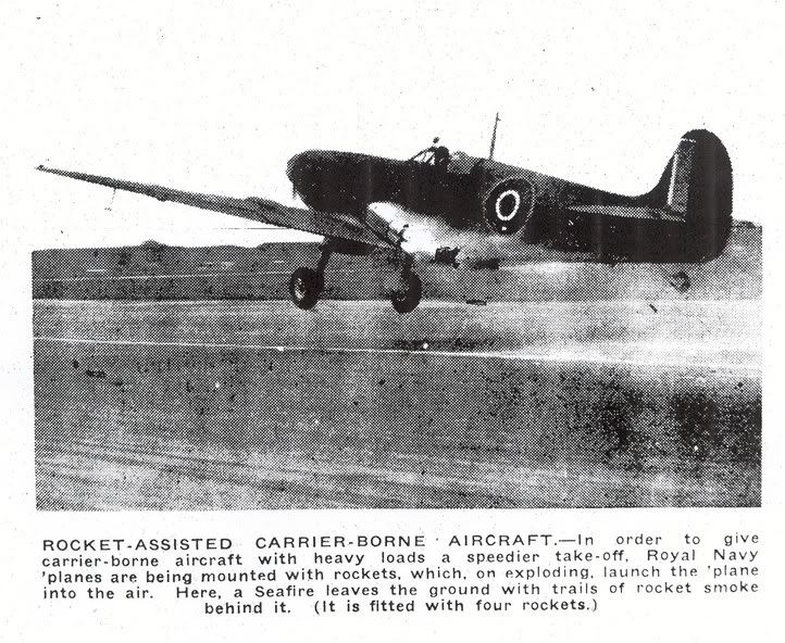

I hadn’t seen this before, a Rocket Assisted Take Off unit on a Spitfire. How often did this happen?
This photo appeared in New Zealand Observer magazine dated 7th of Feb 1945

By: Mark12 - 14th April 2005 at 09:53
Cheers Mark,
The photo I posted looks more like a Merlin engined Seafire. Would it have been a prototype?
It must have looked good seeing them take off from a carrier with RATO, if it did actually happen.
Dave,
This is a well known photograph and I suspect that it is the Press Release shot.
As with all things ‘Press Release’ in wartime, there may well have been a hidden message to the axis powers.
This presumed Seafire III is most probably a/the trials aircraft.
I would be interested to learn of any operational or training use of the Rocket Assisted Take Off Gear on both Merlin and Griffon powered Seafires.
Mark
By: Dave Homewood - 14th April 2005 at 09:26
Cheers Mark,

By: Mark12 - 14th April 2005 at 08:59
Dave,
Most of the Griffon Seafires had this facility with the hard points built into the structure, just aft of the firewall. The pilot has a toggle to a spring loaded ‘Bowden’ cable to release the RATOG unit after take off.
Rarely used I suspect.
Mark
