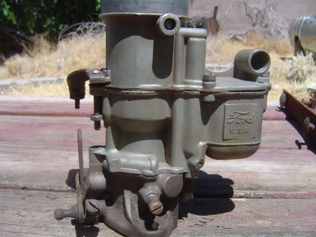

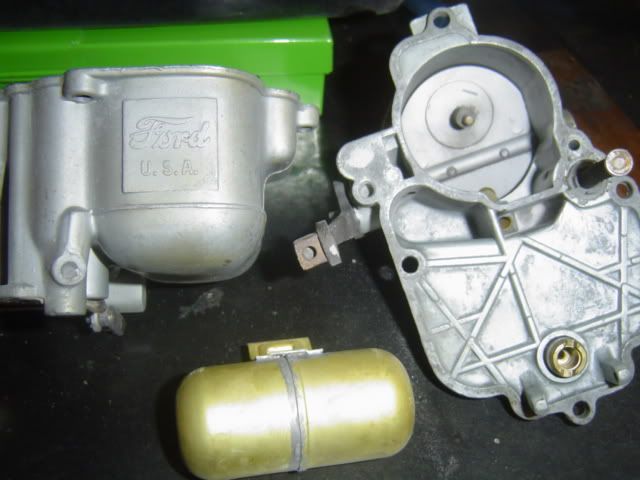

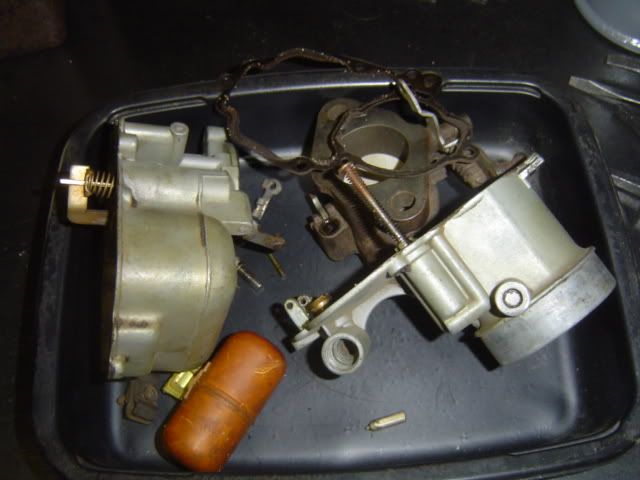

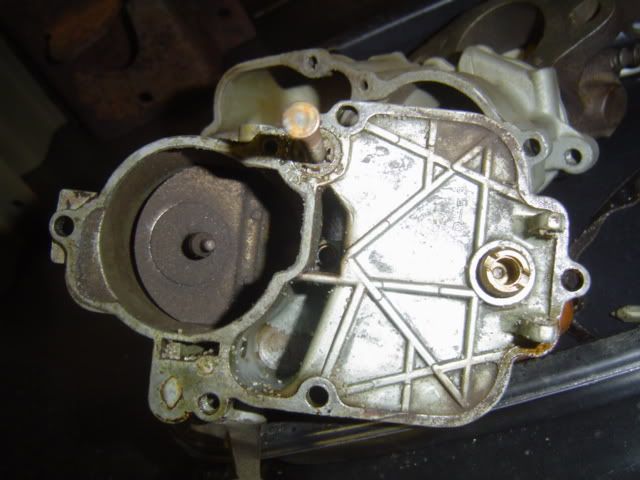

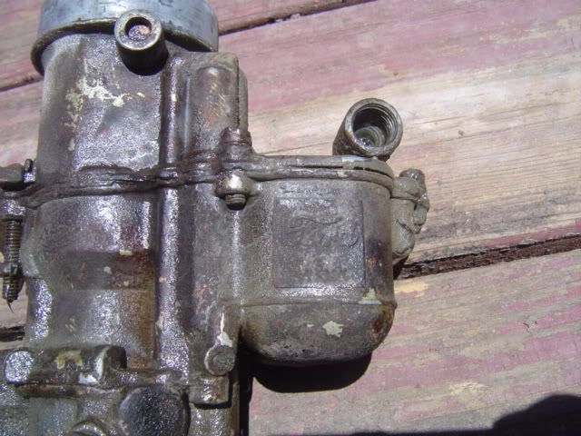

Carb as removed:
http://img.photobucket.com/albums/v317/ZRX61/G8T%20Project/5-19-10-8T012.jpg

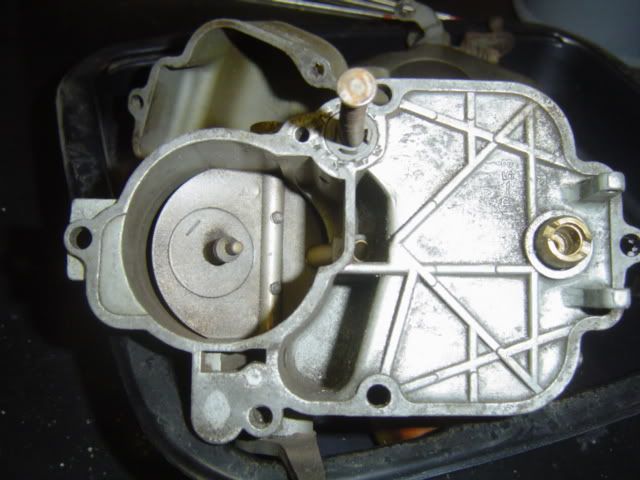

After plastic bead blasting:
http://img.photobucket.com/albums/v317/ZRX61/G8T%20Project/5-19-10-G8T004.jpg
http://img.photobucket.com/albums/v317/ZRX61/G8T%20Project/G8TCarb001.jpg
http://img.photobucket.com/albums/v317/ZRX61/G8T%20Project/G8TCarb005.jpg

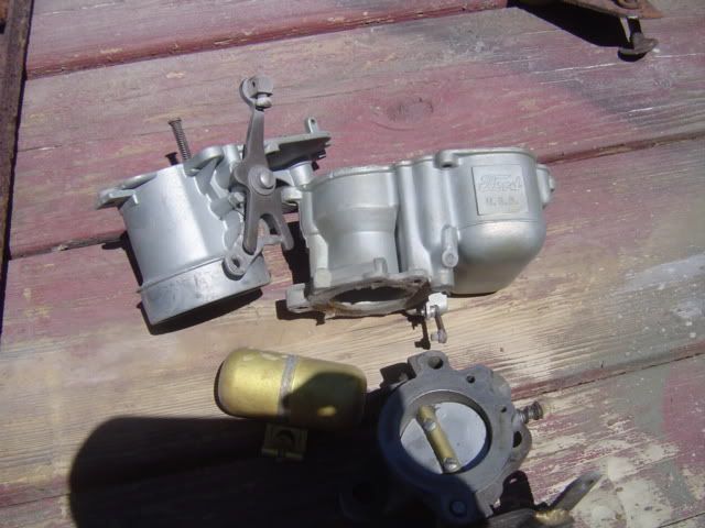

& then soda blasted:
http://img.photobucket.com/albums/v317/ZRX61/G8T%20Project/G8TCarb006-1.jpg
http://img.photobucket.com/albums/v317/ZRX61/G8T%20Project/G8TCarb010.jpg
http://img.photobucket.com/albums/v317/ZRX61/G8T%20Project/G8TCarb006.jpg

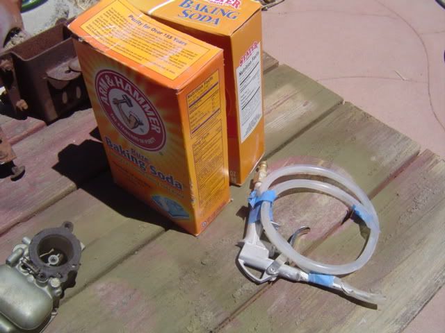

Using this $10 soda set up:
http://img.photobucket.com/albums/v317/ZRX61/G8T%20Project/G8TCarb002-1.jpg

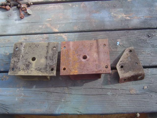

By: ZRX61 - 2nd July 2013 at 20:34
Before (middle) & after (left) of steel part left in molasses for somewhere between 7 & 10 days (I forget)
http://img.photobucket.com/albums/v317/ZRX61/G8T%20Project/1-11-12002.jpg
