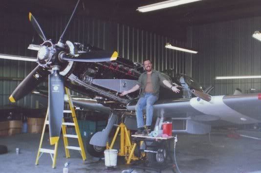

When I was out at Camarillo earlier this year one of the CAF guys working on Dave Prices old Mk14 said to me “What the **** were you guys thinking when you built these???”
I just smiled 🙂
I also reminded them it ran fine when I last worked on it…. I was a bit thinner then….
My standard answer to Americans asking why the prop has “so many blades” was “because our aircraft are way more powerful than yours”
