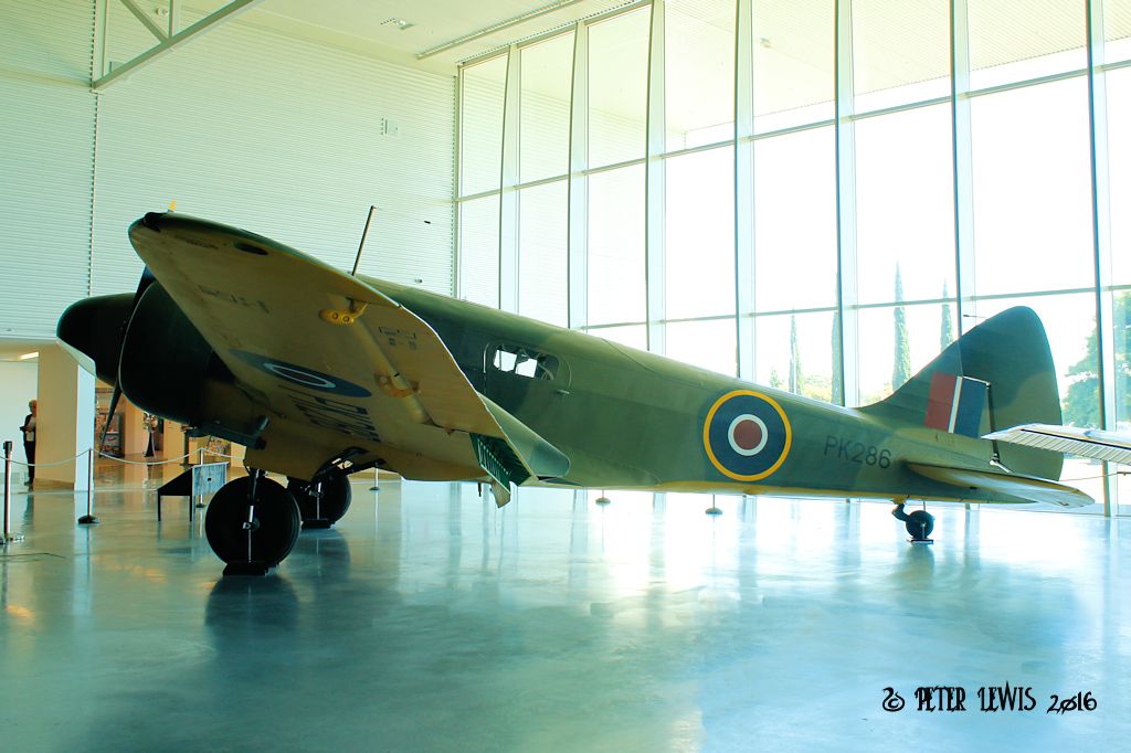

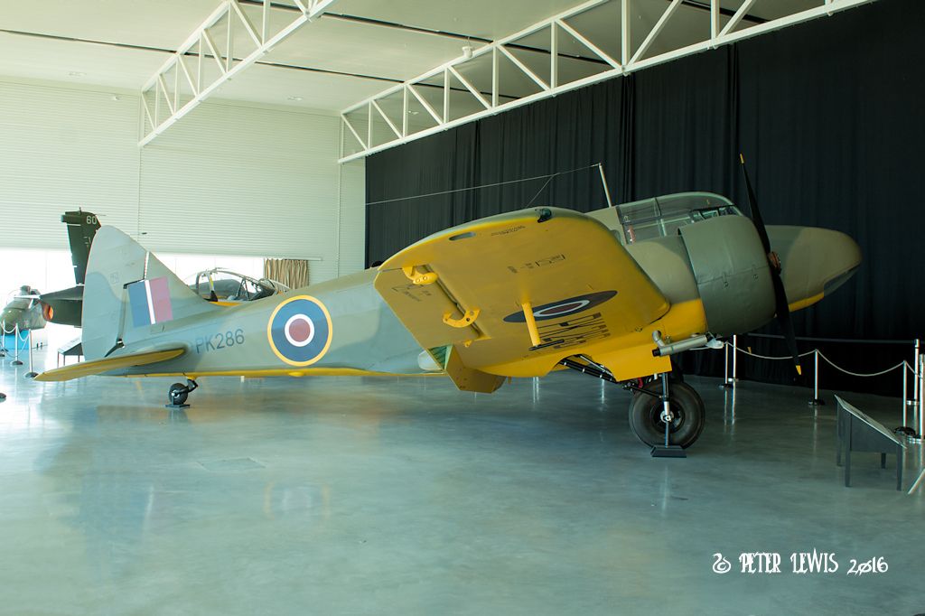

Managed just 40 minutes at the Air Force Museum, Wigram, yesterday morning.
So of course I headed straight for the Oxford.
It is now in the front display area along with PAC Airtrainer NZ1948 and Aermacchi NZ6460 as a ‘trainer row’ replacing the Skyhawks that used to inhabit this area.
Only pity is that they don’t also have a Harvard in there.

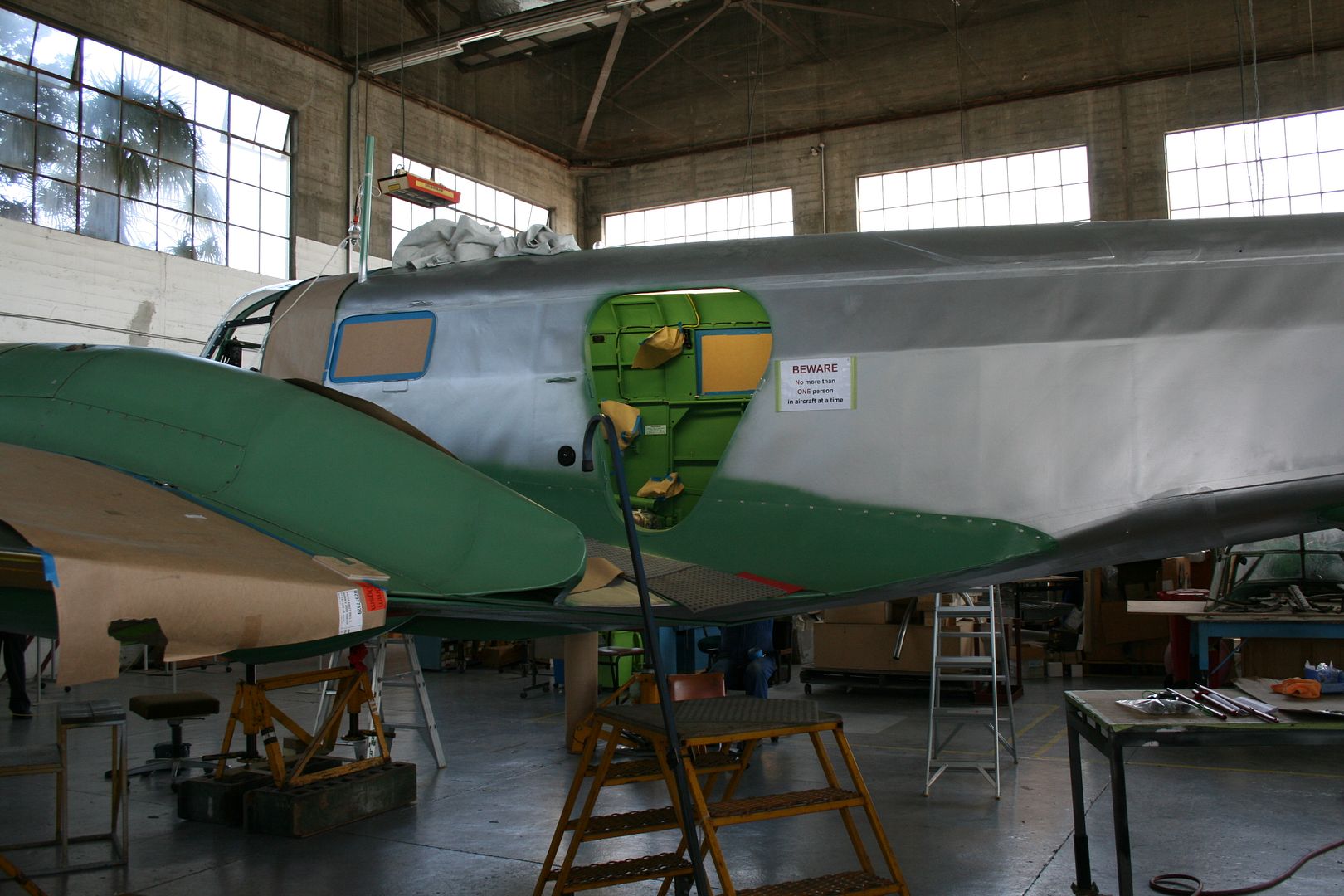

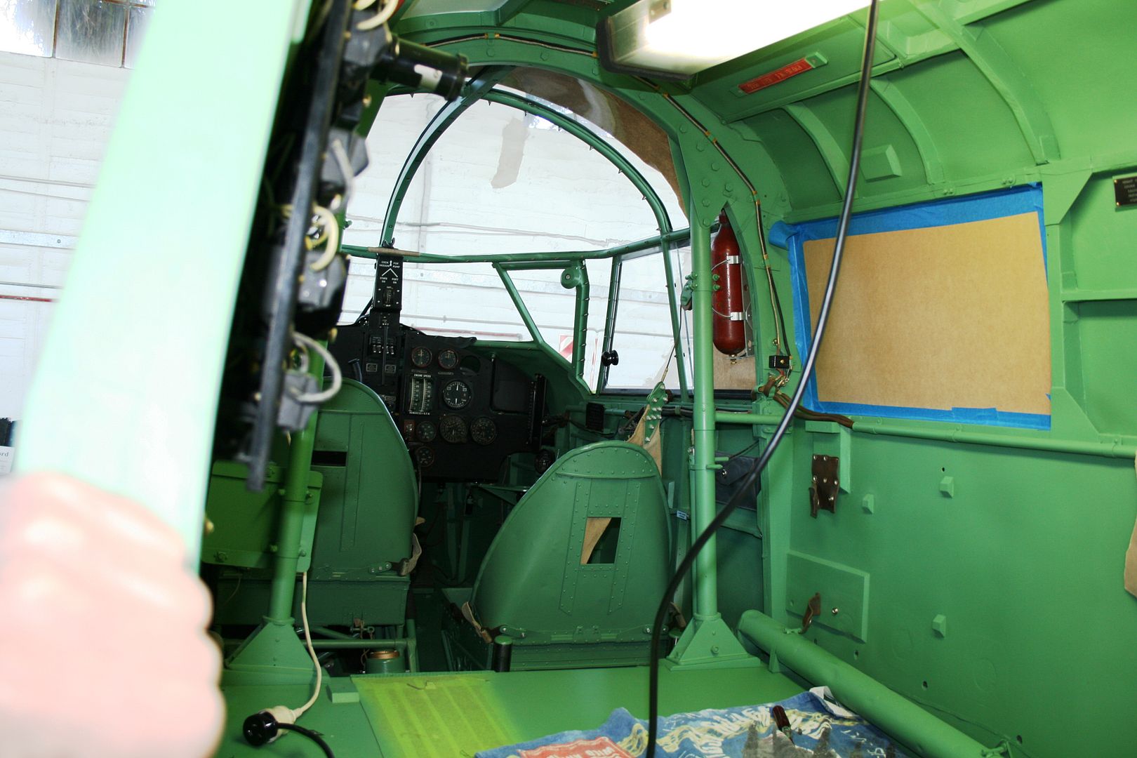

By: John Aeroclub - 3rd February 2016 at 20:35
Taken in December last, showing superb progress by a dedicated team.
