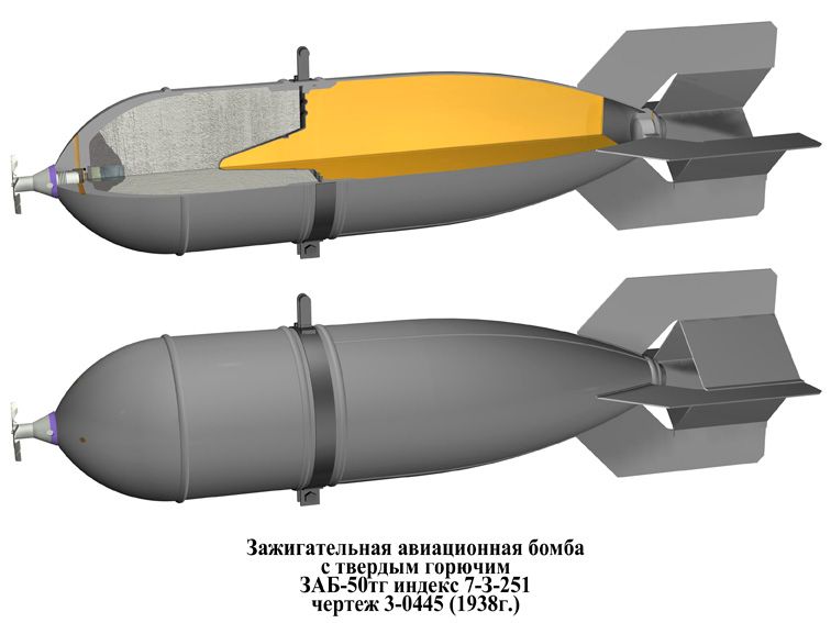

What’s the wire for going into the base of the bomb case? I have seen a fuze arming vaine for sale like the one in the cad drawing which would probably fit yours.

The front of the nose cone had been melted when it struck the ground and the contents ignited and burnt the steel away to leave a large ragged hole.
Under the harness strap – the top nose cone unscrews.

This bomb looks very similar to WW2 Russian ZAB-50tg fire bomb:
http://i788.photobucket.com/albums/yy169/19711011/417041004110-50442043303-04451_zpsba806e1e.jpg
This bomb has solid flammable composition inside.
The title under drawing says:
Aircraft Fire Bomb
with solid flammable substance
ZAB-50tg Code 7-Z-251
technical drawing 3-0445 (year 1938)
