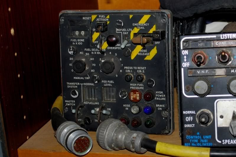

Does anyone here have a picture, or reference from a manual, that shows the optional fit air-to-air refuelling control panel in the Sea Vixen when it was used as a tanker aircraft?
Thanks in advance, James

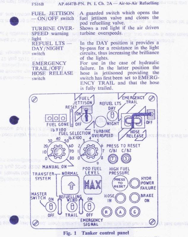

Hi Matt this is from the Pilots Notes which has a whole section on tanking,
http://i9.photobucket.com/albums/a82/pagen/SVTanker.jpg
http://i9.photobucket.com/albums/a82/pagen/SeaVixentankercont.jpg
Give me a PM if you require the FAW.2 PNs.
As an aside, this same control panel was universal to all ‘buddy’ pack tankers, does anyone know where it was fitted in the Scimitar (the only British single seat tanker?) and where and if it was used in the Victor K.1s or 2s?
