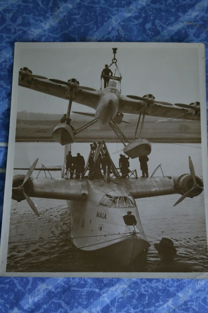

Not a problem, I have been meaning to do it for some time. The loading certainly looks like a tricky operation. Looking at the image, there is in fact two chaps sat on the starboard float. Could they be counter-balancing against wind? The surface of the water on the left hand of the image shows the sort of ripples created by a mild wind (mild of course until you are trying to carry out a precise operation such as this).
By: RPSmith - 24th June 2008 at 22:59
Thanks for posting the pics.
I am intrigued at the angle “Mercury” is hanging at – the chap on the starboard float may be acting as ballast to reduce what was an even worse angle?. I believe some single-engined seaplanes such as the Schneider Trophy racers could transfer fuel to one float as ballast to counteract torque when taxying/taking off but “Mercury” wouldn’t have had that problem.
Anyone any ideas??
Roger Smith.

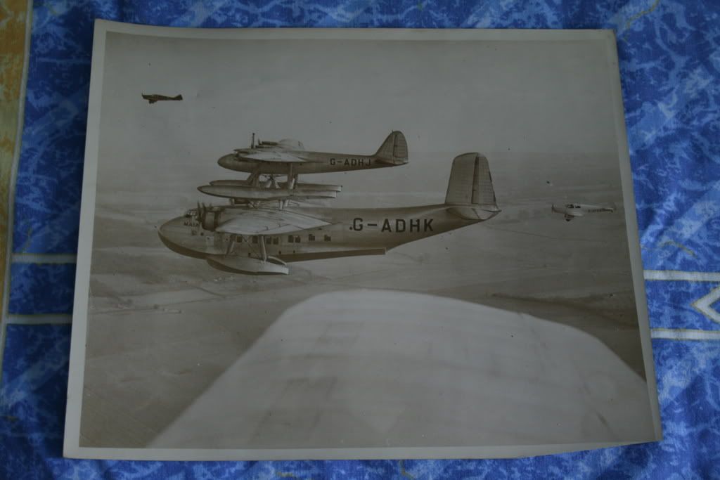

Evening chaps, just dug out the ‘looking glass’…the aircraft on the right handside is a Miles Falcon Six, registration G-AFAY. The aircraft on the left handside is also a Falcon six, howeve I am really struggling with the registration. The first two letters are G-A, the third looks like F and the fourth L but it doesnt bring any results that match. Any further guesses?

A quick look at a magnification leads me to think that the rearmost miles is G-AFBV which was a Miles M11A Whitney Straight. Does it look anything like one? I thought they looked like Falcons.

Chase aircraft to record the first separation? Unlikely to be Short Bros aircraft – I would have expected them to use their Scion. Possibly press?
The weather on 5th Feb 38 was too rough for the planned separation to take place and it took place the next day as a spur of the moment thing because conditions were ideal, all apparently unobserved. Remarkable really considering the number of aircraft following the day before.
The well known sequence of photos and film is of the second separation on 23rd February.

Mmmmmmiles:D The composit is escorted by what looks like two Miles M3 Falcons, and the wingtip visible in the picture looks very “Miles”. I seriously doubt this is a trial flight. Two (maybe three) aircraft from a different manufacturer would not be so close on a trial flight, IMHO. Would be great to know the reggies of the two Miles aircraft. Can anything be made out on the original?

I was given these two photographs a while ago, i’ve quickly searched google to ensure i’m not wasting anyones time with repeats…
They are copies, both have labels glued to the back. I’m afraid I don’t have a scanner, so photographs will have to do.
The below image is dated 5.2.38 and is noted as being a trial flight.
This image is dated January 26th, and as being at Rochester. “Further Trials”.
