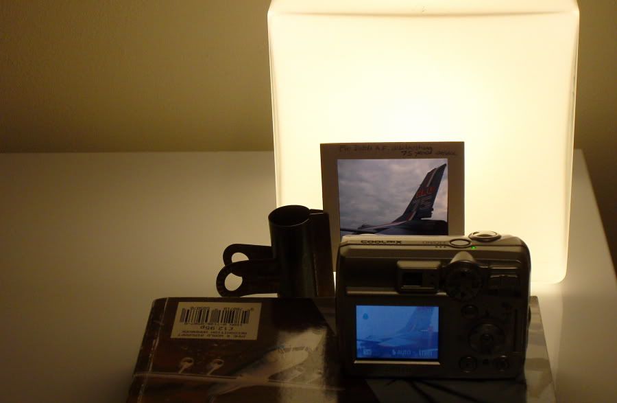

Just thought I’d share a quick,easy and very cheap method of slide copying;):).I took the set-up photo with an 8 mega-pix compact and it gives you some idea of what I was doing.I set the small compact on “close up” and gave it a 10 sec., delay on the timer,focused on the slide and hey presto a digital copy.
The timer helped the camera to settle and there was enough light from a 40watt bulb to bring these old medium format images to life on digital.If you have some under exposed slides just bang in a brighter burning 60watt bulb and it will help.You can alter the height of the slide to line it up just by moving it up and down the clip:eek::).
