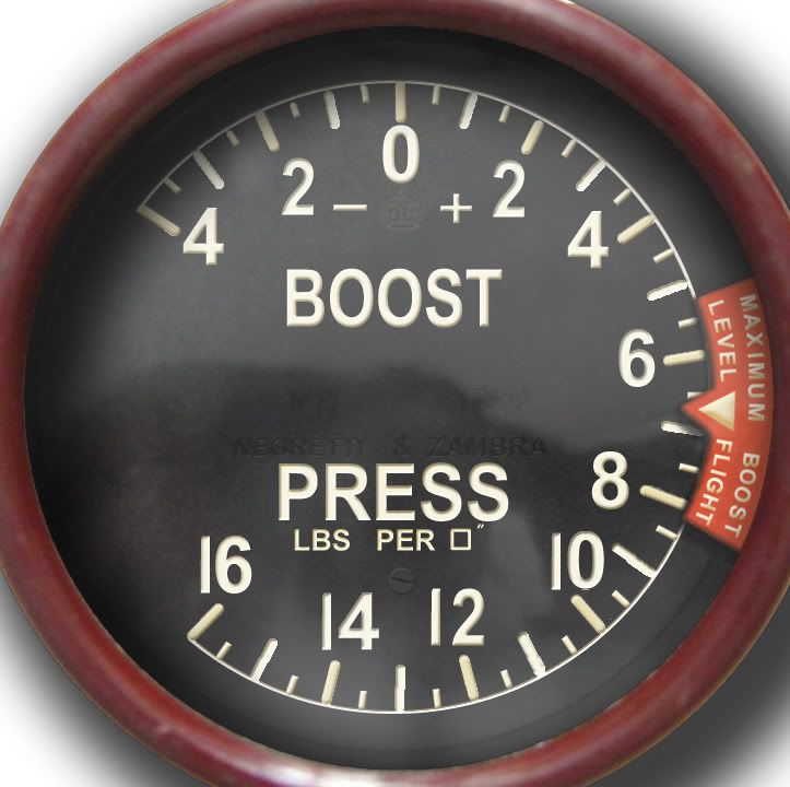

Boost is the Plumb Red colour as are the Oil Gauges, Rad Temp early are also the plumb red but the later Bakelite have a blue bezel, this is one we can’t find a good colour reference for, anyone help? Oil pressure either Yellow or Brown, although the Whirly images we have only show the Brown versions again it would be nice to see a good colour reference for the Yellow…
Here’s an example of our Boost Gauge for the 3D cockpit, recently made by a very talented chap whose helping us get our project finished…
http://img.photobucket.com/albums/v187/Secudus/th_BOOST-16copy.jpg
